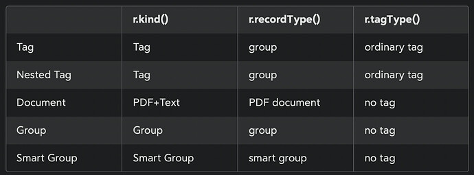

It also required different testing criteria because kind and recordType do not return the same values:
