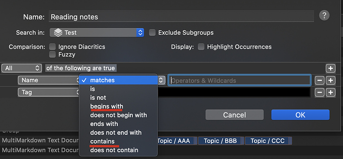

As you can see, this setting is unable to filter out the expected results. Actually I can understand the reason, because “book” is not the Tag of the file XXX Note, but the Tag of the group XXX of the file XXX Note.
So I set up some smart rules. Let the group get a prefix with the same name as the tag, like this:
But a new problem that I didn’t think about appears:
There is only the option of is / is not, no option of begins with / contain. As a result, I can only filter out files in a specific group(1) with the “Book” tag(prefix), not files in all group with the “Book” tag(prefix).I can also understand the reason, because now, for file XXX Note, “Book” is the prefix of the filename of its group tag.
Since my previous note-taking system was designed like this (in notion app), I tried to build a similar file system in DT. I don’t know if I made it clear, thank you for your patient answer.
Enable File > Database Properties > Inherit Groups of Tags. The Book tag should then appear on the children of a group with the tag applied.
