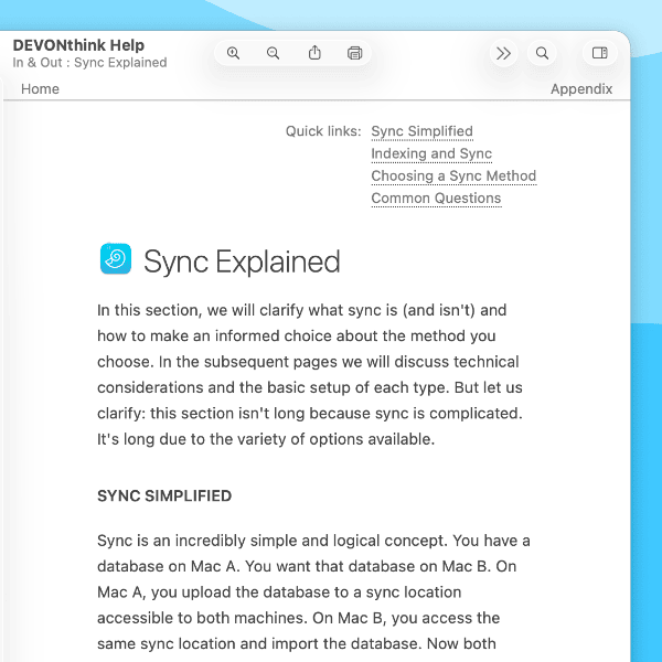

Sync is discussed in the built-in Help and user handbook for both applications. There is a Sync Explained section in the In & Out chapter for DEVONthink and the Sync chapter for DEVONthink To Go. Once you decide what sync method you’ll use, each method has its own section with a description, technical considerations, and simple step-by-step instructions for setting up a new or an existing sync location. If you only have one of our applications, just follow the steps to create a new location on one device, then follow the steps for an existing location on the other device(s). Setting up sync in DEVONthink and DEVONthink To Go is pretty similar but if you want to be sure you can check the corresponding chapters in both handbooks.
