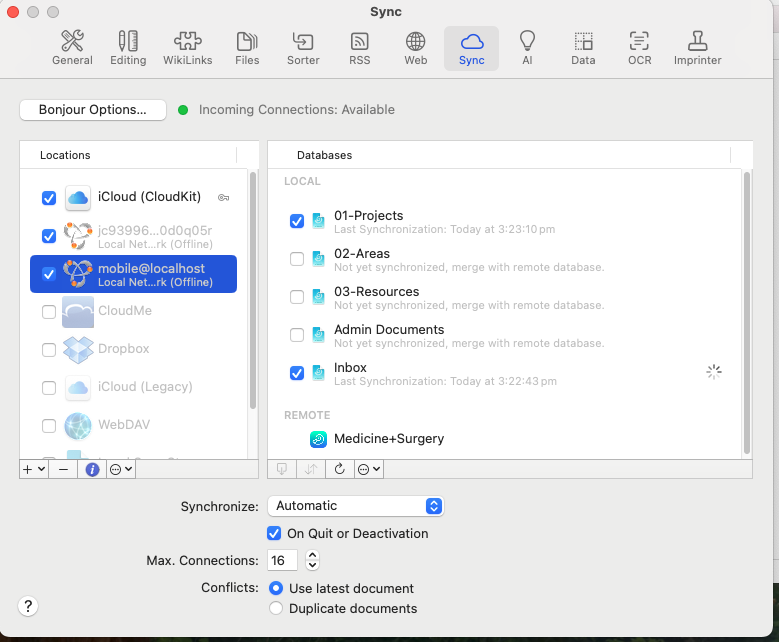

One question: what does checking the boxes in the Local databases section do when linking different iOS devices via Bonjour
{I want to restrict my iPhone to a superficial sync; but download them on the iPad)
see screenshot

Bonjour was another story ~ initially Worked repaired all BDs on the ‘server’ Mac to ensure all DBs were verified and checksumed (!) then - being clear which Mac is to act as the server, NOT creating a new location , then , sorting our Bonjour on the server (resetting the Bonjour password to confirm it is consistent); being pedantic that Bonjour was linking to the other device; having the DBs open, , , resetting the Bonjour password , essentially doing back to basics
Each step a little closer, then realising that the Bonjour connected MBP is identified as a separate location on the server (iMac) but that the iOS devices are needed/ was recognised as a separate Location on the server

Regarding sync, you should not have Bonjour enabled in DEVONthink To Go. DEVONthink is acting as the Bonjour server. This is covered in the In & Out > Sync:Bonjour section of DEVONthink’s and DEVONthink To Go’s Sync > Sync:Bonjour sections of their built-in Help and manuals.
