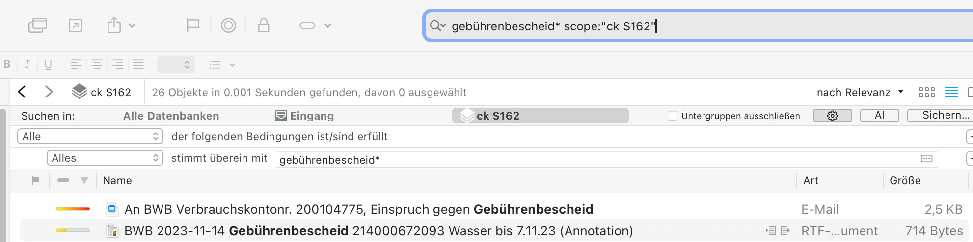

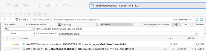

I searched for the lovely word “Gebührenbescheid” in a database containing an annotation file which in turn contains that word. And, lo and behold, the record is found, but there’s no flag. At all.
