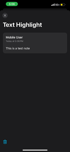

  1. Note created in DTTG3
  1. Icon view after note creation:

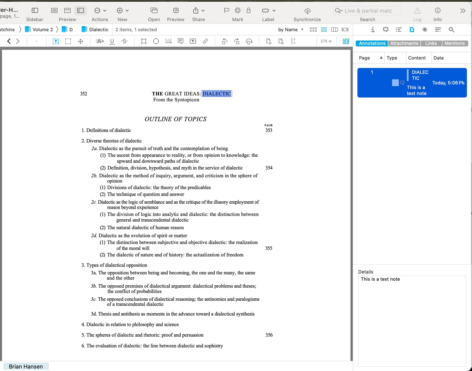

  1. File in DT3 with the annotation view in the document pain
  1. Note viewed with selected highlight - note that there is no icon in the document pane.
  1. After modifying the note locally the icon appears in the document pane.

  1. The PDF frameworks aren’t the same, so i suppose this is a bit unsurprising. Development would have to assess this.
  2. The details in an annotation belong to it. Theres no built-in exporting each of them individually. You can select and copy or drag and drop annotations to produce a sheet with the annotations’ information.
