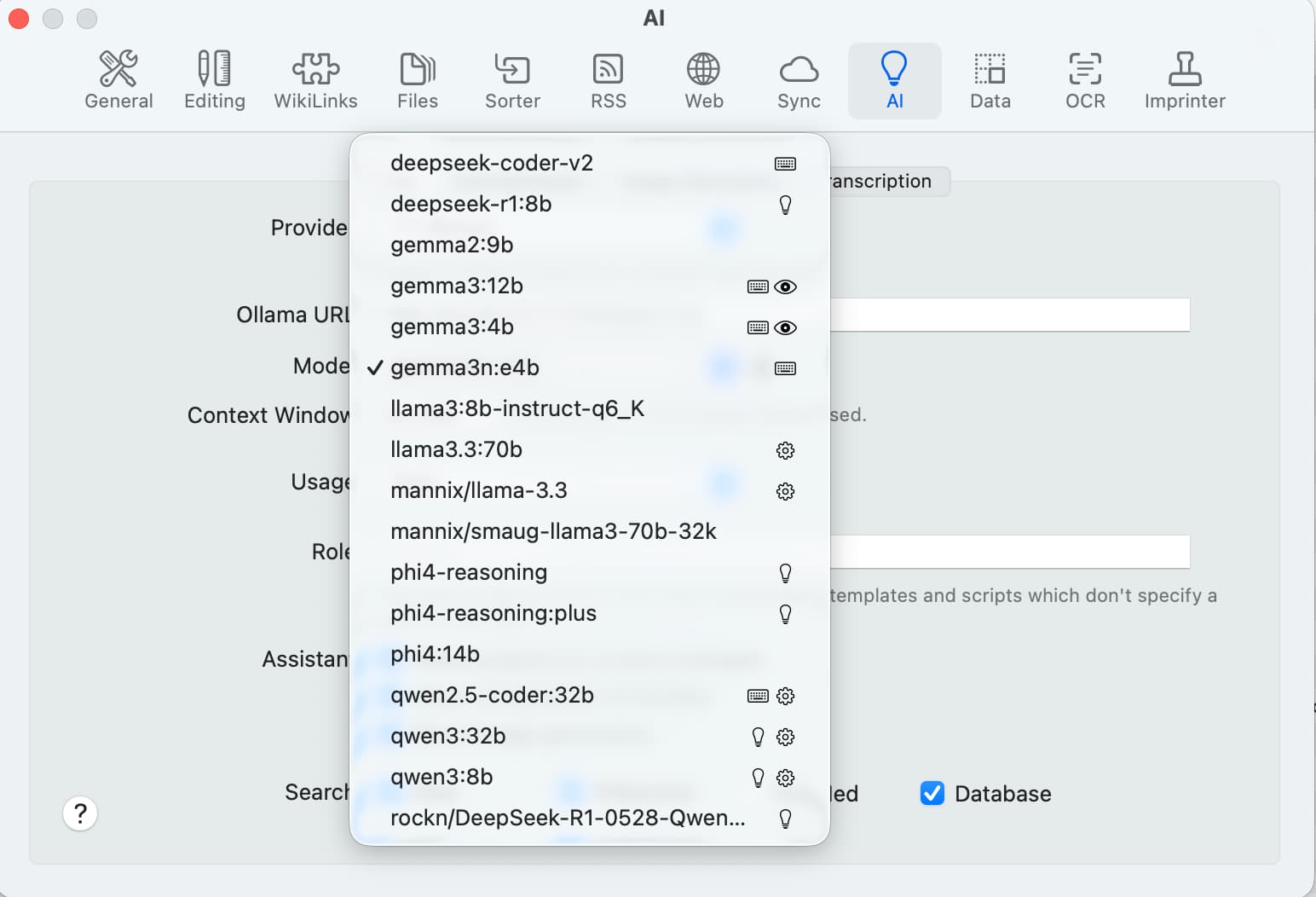

Not all AI models do all things (and yes, this is documented). Some support tool calls, others don’t. Some may but aren’t as capable as others.
The property icons in the Models dropdown, e.g., in the AI > Chat settings or the Chat assistant, generally indicate each model’s supported functions.

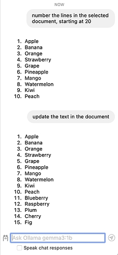

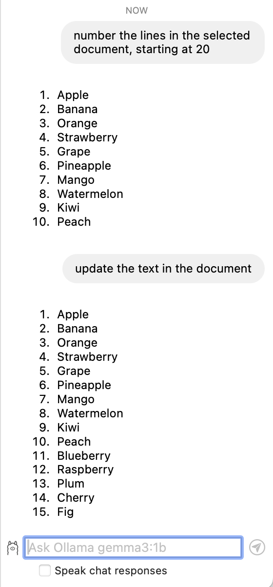

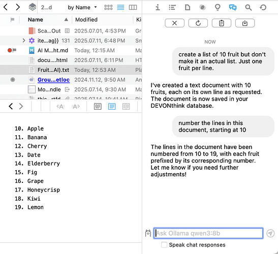

Here is an example using Qwen3:8B. Bear in mind, I am on a 16GB Mac, so that’s likely the most performant Qwen3 model. All told, it took well over a minute for it to just prefix each line with numbers, but it did it.
And some hallucinating, for your viewing pleasure…

Are those feature capabilities of the models communicated to DEVONthink (from ollama in this case)?

And per @BLUEFROG, if I had noticed the icons on the model dropdown (and paid attention to them), I might have seen the issue. It looks like the models I currently am testing are limited regarding the “tooling” icon which probably explains why most wanted to just stick to the chat window. Although they all seemed to read the file fine.
In case of models without tool call support contents and properties are automatically provided.
