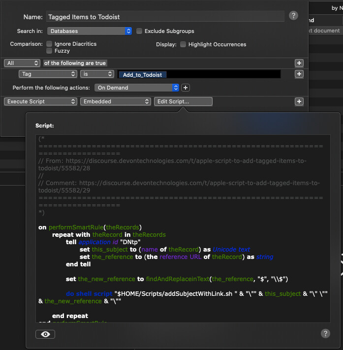

I need some help troubleshooting, please. The shell script works from the command line:
~/Scripts/addSubjectWithLink.sh Test https://google.com
creates a task in the Todoist inbox linked to Google.
The Smart Rule finds the correctly tagged items, but when run–nothing happens. No error, nothing.
I copied pasted your script above and then fixed the line to read:
do shell script "$HOME/Scripts/addSubjectWithLink.sh " & "\"" & this_subject & "\" \"" & the_new_reference & "\""
Does it work if you use the full path instead of $HOME? In addition, depending on the name of the items you might have to use quoted form of, e.g.
do shell script "/Users/YourUsername/Scripts/addSubjectWithLink.sh " & quoted form of this_subject & " " & quoted form of the_new_reference

I get the task created in Todoist but it just has the title of the note and the link doesn’t show up. I copied the final one version. Do I need to make edits to the script? TIA!
are you sure that the link is not in the task?
The title of the note shoud be a clickable link in todoist.
If not, make sure that the shell script contains the following content:
