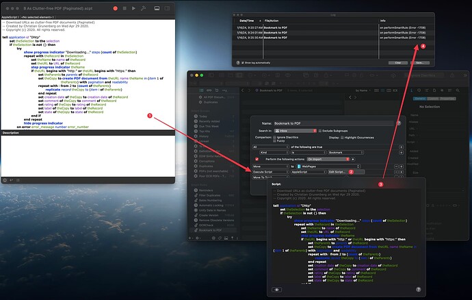

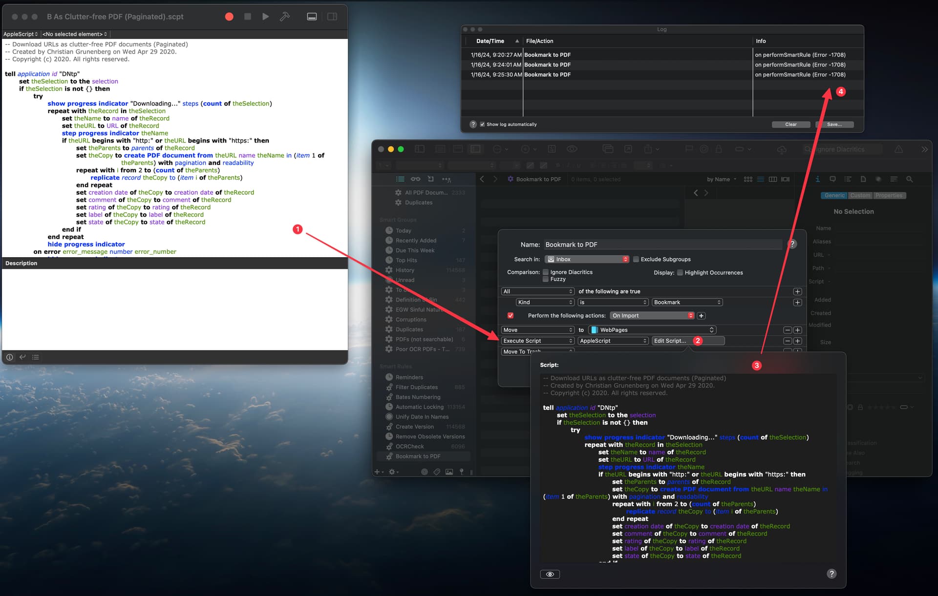

-- Download URLs as clutter-free PDF documents (Paginated)
-- Adjusted for use with DEVONthink smart rule.
-- Original script by Christian Grunenberg.
on performSmartRule(BookmarktoPDF)
if BookmarktoPDF is not {} then
try
show progress indicator "Downloading..." steps (count of BookmarktoPDF)
repeat with BookmarktoPDF in BookmarktoPDF
set theName to name of BookmarktoPDF
set theURL to URL of BookmarktoPDF
step progress indicator theName
if theURL begins with "http:" or theURL begins with "https:" then
set theParents to parents of BookmarktoPDF
set theCopy to create PDF document from theURL name theName in (item 1 of theParents) with pagination and readability
repeat with i from 2 to (count of theParents)
replicate record theCopy to (item i of theParents)
set creation date of theCopy to creation date of BookmarktoPDF
set comment of theCopy to comment of BookmarktoPDF
set rating of theCopy to rating of BookmarktoPDF
set label of theCopy to label of BookmarktoPDF
set state of theCopy to state of BookmarktoPDF
hide progress indicator
end try
end performSmartRule
It is not helpful to post code as screenshots. Just requires more work for the audience to read it (especially if it’s in dark mode). Please post code as such, namely included in three backticks
code goes here
As to your script: Please read the corresponding part of the manual thoroughly and check out sample code here in the forum (searching for ‘on performsmartrule’ should turn up enough hits).

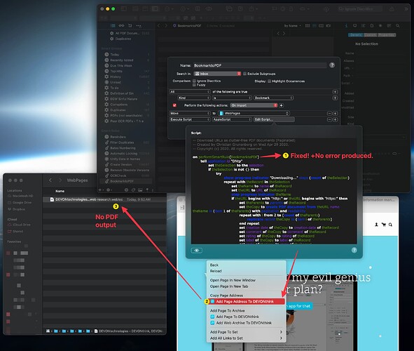

Simply wrapping the script in a handler doesn’t cut it, as the script itself works with the selected records, while a smart rule script receives the records as a parameter of the handler. You wrote that part, but then you didn’t adjust the rest of the code, so it’s working with a selection which is non-existing. Consequently, you convert 0 records of an empty selection to nothing.
What was your query to ChatGTP and did you just paste the code into the request?
By the way, as I looked at this more closely, you’re not going to bypass those cookie or login issues. When you’re using the clutter-free option, there is no login or cookie information being passed through the clutter-free mechanism.
A bit long to paste here, so here’s the interaction.
Thanks for the assistance! It got me to the result I needed, even though I have to use the less desirable clutter-free option. It’s a bummer since clutter-free auto-removes the article publication dates for the ~800 pages saved.
