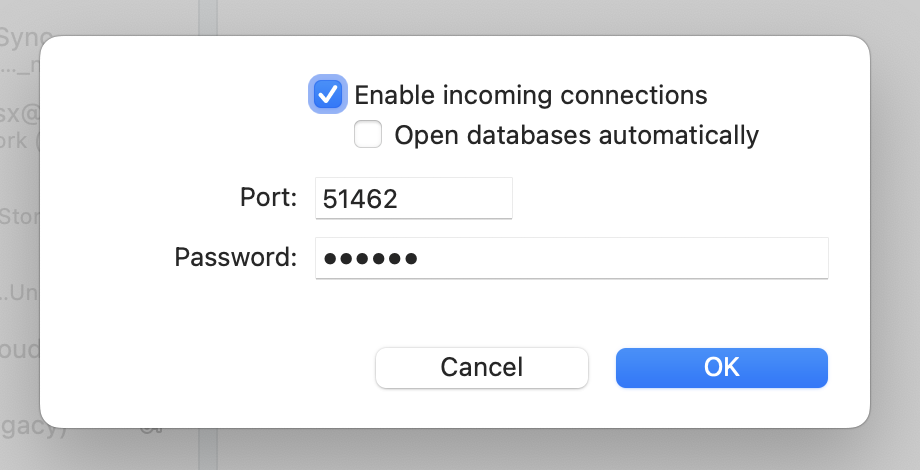

Enabled Bonjour on the Mac (Preferences → Sync → Bonjour Options, checked “Enable incoming connections” and “Open databases automatically”, entered a password, left “Port” blank although DT seems to have auto-filled 56846).

You need to use the mandatory Bonjour password you specified in Preferences > Sync > Bonjour Options > Password. You had to have entered one as you can’t do the setup without one.
