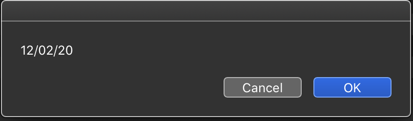

I have tried lots of responses which work from the clipboard but not from a dialog bog. One example is here where the input is acknowledged in the debug output code but still no vales are updated in the custom metadata fields:
Just a heads-up: User interactions like dialogs aren’t suggested for use in smart rules. This would be better used with a script. In fact, I would test it with a script to see if it works.
Well that is getting us a bit closer due to increased error reporting when running as a script rather than as a smart rule.
Running the script pointed out some quotes I was missing in the last statements.
This is my script now:
When I run it the dialog box output is correct and then I get this error - I get it regardless of whether my input has the slashes or is just straight text.
Why are you entering text theDateEntered ? text is not a parameter for that command in the dictionary.
OK that solves - it - I had put the text in as I was debugging the syntax for entering dates. The main issue had been the lack of quotes at the end.
