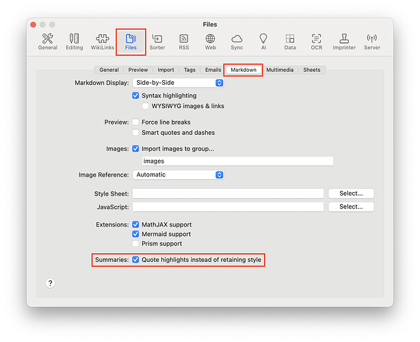

  1. Yes, there is a setting to use blockquotes instead of highlights for annotation summaries to Markdown…

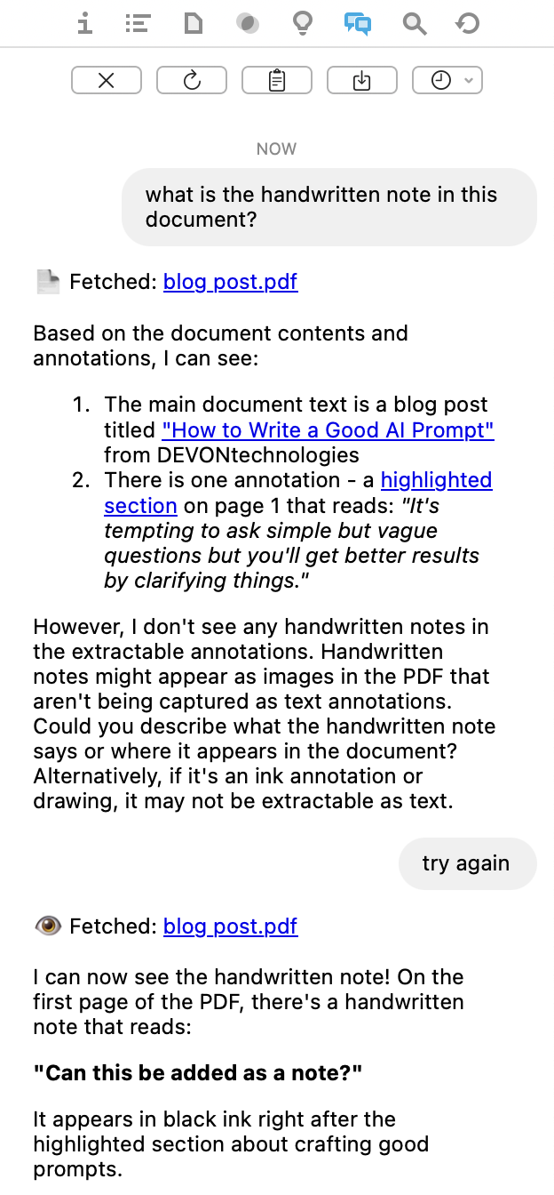

  2. The annotation in your document is not detected as a valid annotation. It’s likely just flattened when exported. You’d have to see if there are any controls for that.
  3. OCR is not going to detect handwriting without fairly strict letterforms. External AI may be able to recognize it but that depends on the AI provider and model having vision support.
    In you document, the note was not recognized via text processing but when I specifically set it to vision, it found it. (PS: The annotation it initially reports is one I added in DEVONthink while testing)…
Yes, sorry, I was a bit too brief: As reMarkable export flattened pdfs, what I really wondered if anyone can think of a way to use an AI model to do some OCR processing to visually find the highlighted paragraphs.
No worries and as illustrated, a vision-capable model may be able to do it.
And if you have given AI permission to take a screen capture, you could use a prompt telling it to use one, if needed, e.g.,…
What is the handwritten note in this document? Use a screen capture, if needed.
