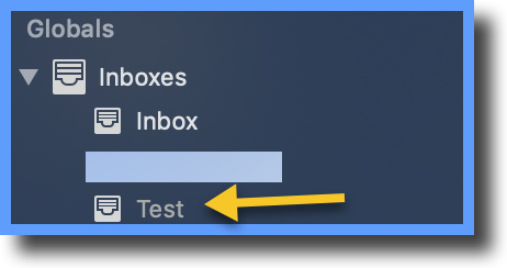

If I create a Test database, this is what’s shown in the database itself:
But, then at the top under Globals, the Test inbox is there:
I am dragging from a file on the desktop into the inbox.
If I “apply rule”, it works so it appears the inbox is correctly identified, but if there should be an inbox in the actual database itself, not in Globals, I’m not seeing it.

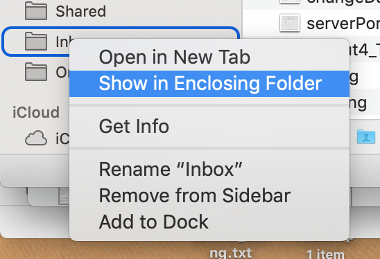

In the Finder, control-click the Inbox and select Show in Enclosing Folder
