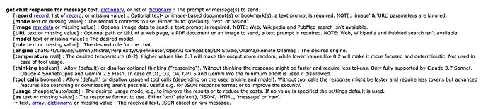

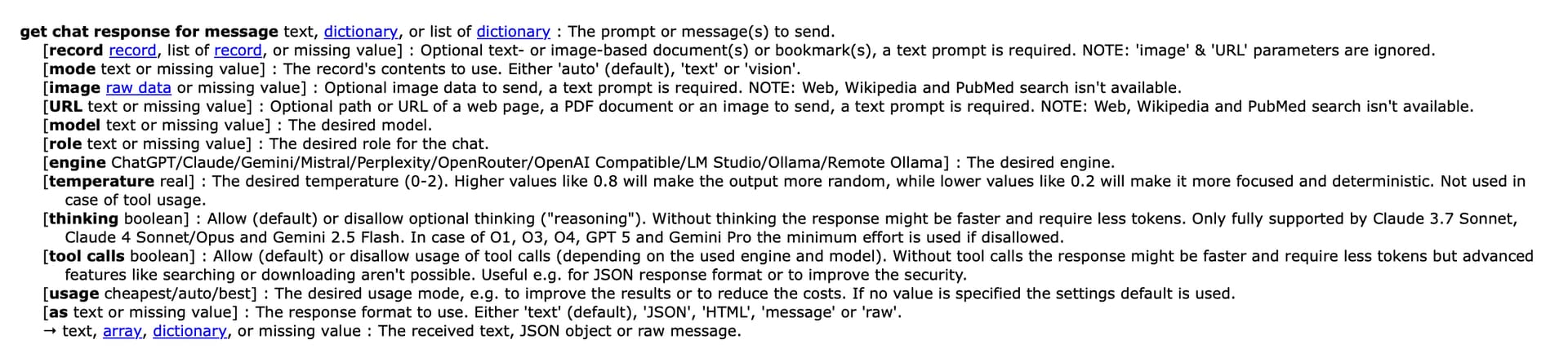

Are there switches or parameters for the web search or other options also? I’m thinking of using a script to orchestrate a cascade of actions.. the web search is too handy in DT, (beats fighting with bright data or searxng!)
These are the available parameters…
Thank you! I’m particularly embarrassed that I wasn’t finding that in the script dictionary!
The model can be changed in the Chat assistant on demand, see pop-up menu in the lower left corner. In addition, the possibility to change e.g. search options likewise is already planned.
