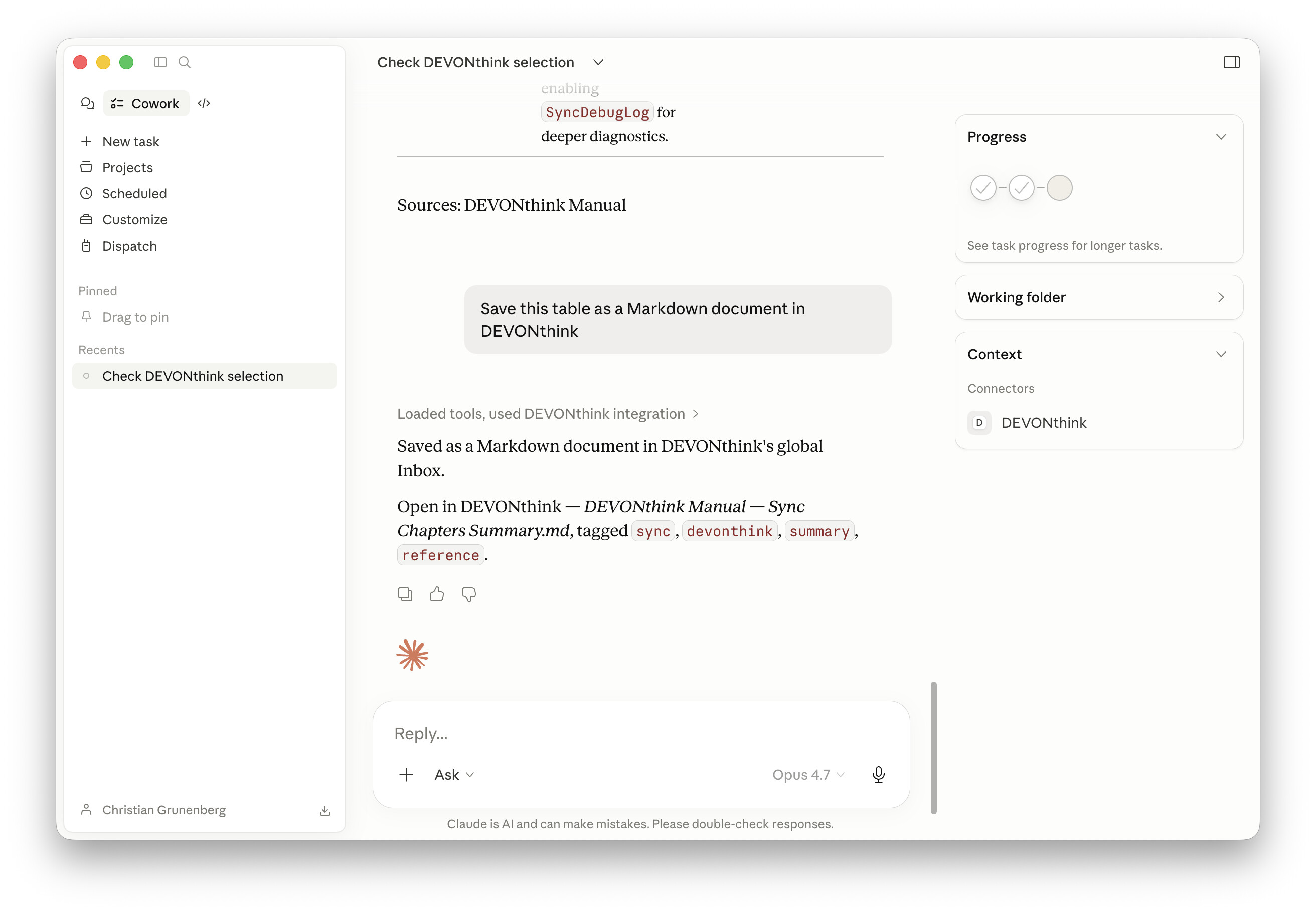

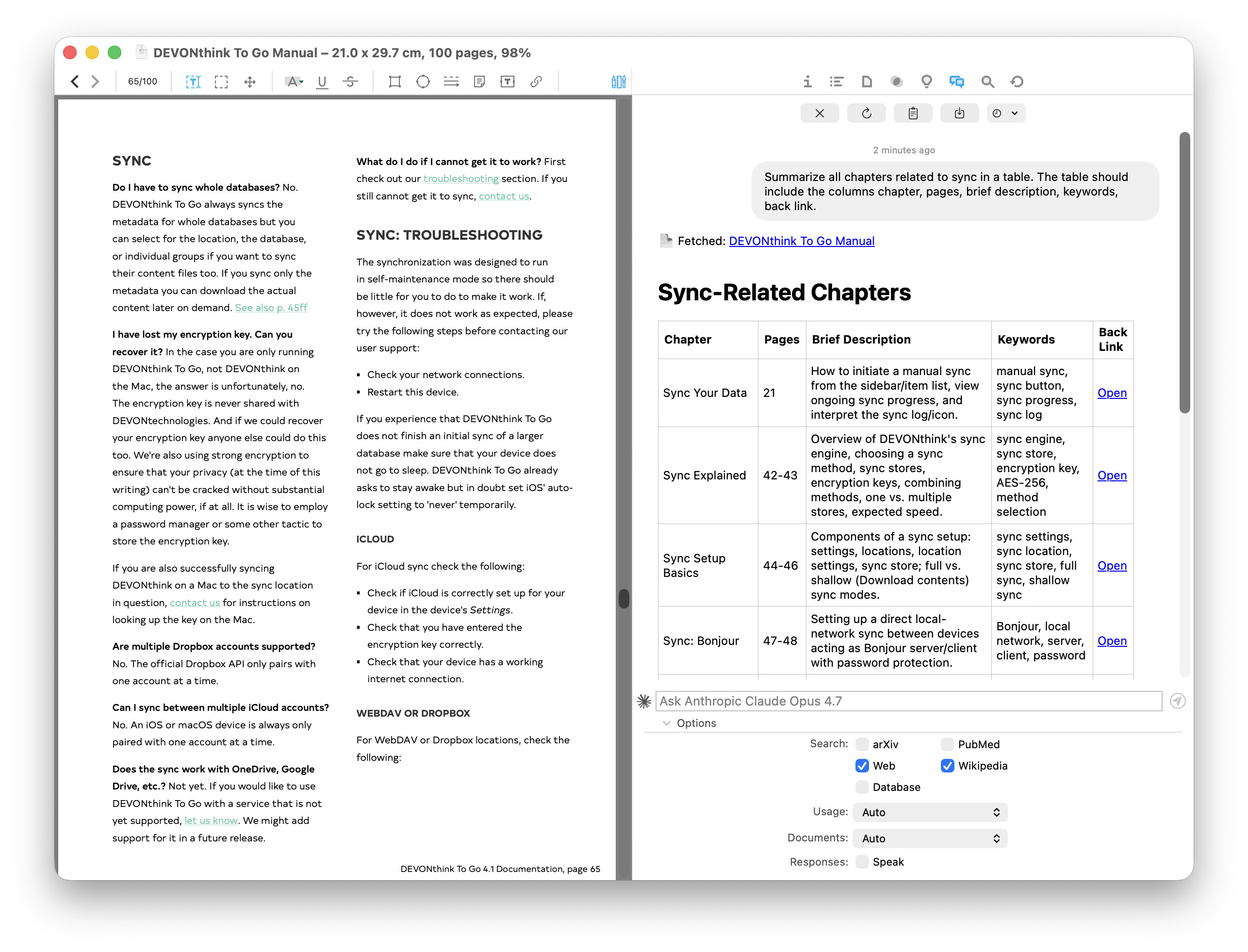

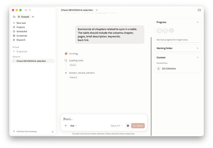

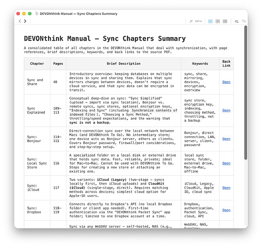

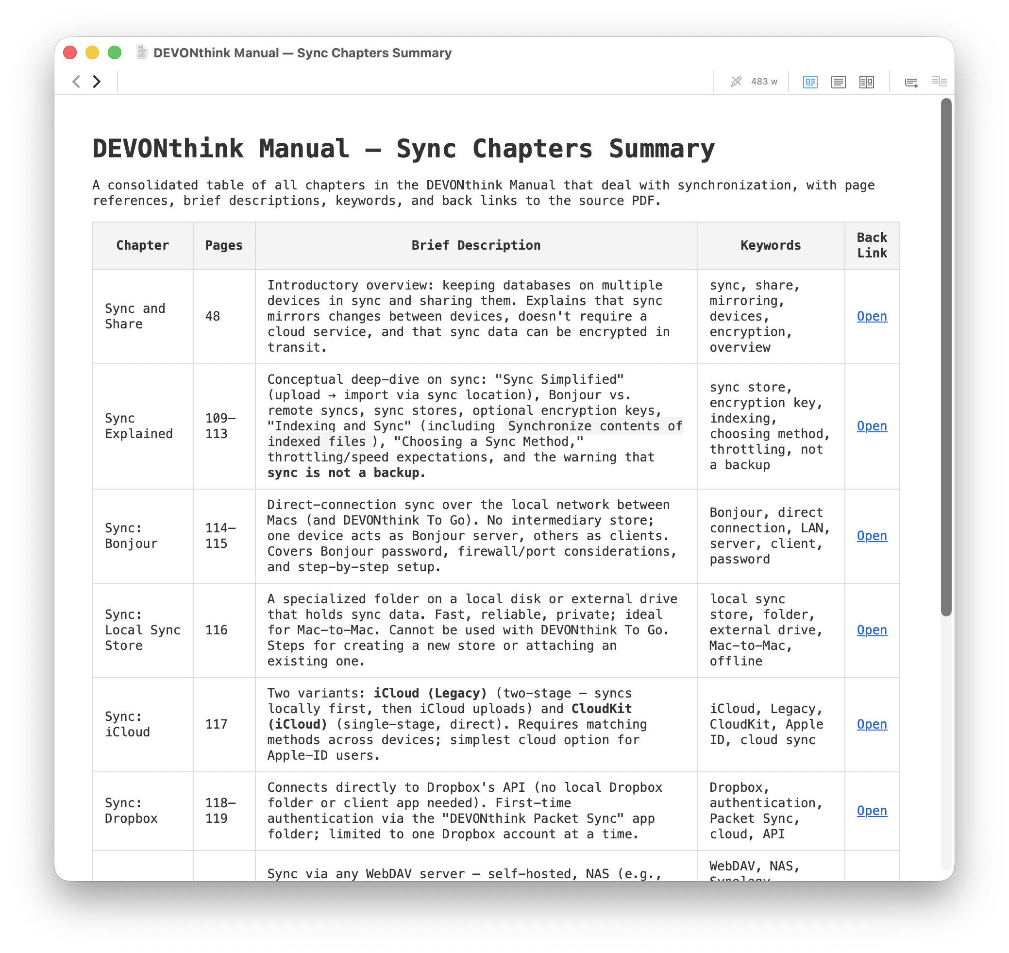

This shouldn’t be an issue in DEVONthink’s chat assistant as links (including email addresses and item links) are both simplified and anonymized for LLMs to improve privacy & reliability. And all tests of Opus 4.7 in DEVONthink have been successful so far (no broken links, no redundant or unnecessary tool calls)
