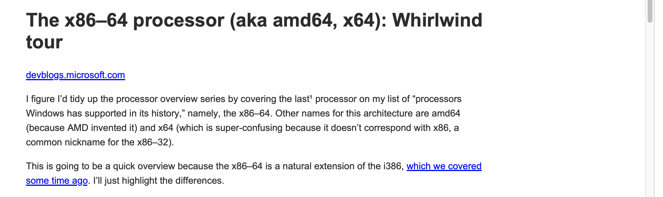

Sure, no problem. Here’s the RTF version:

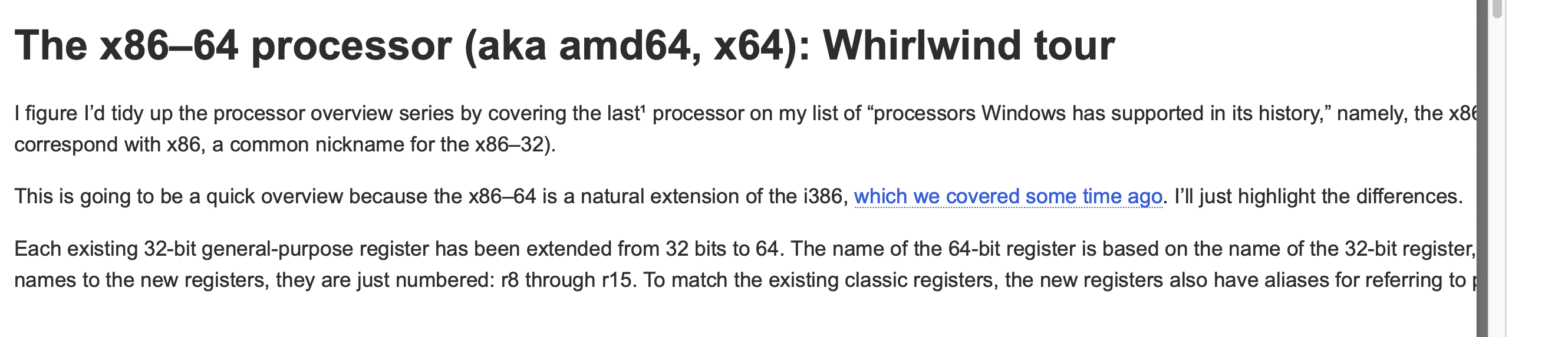

And the PDF version:
Note that in the PDF version the text is truncated at the right hand side.

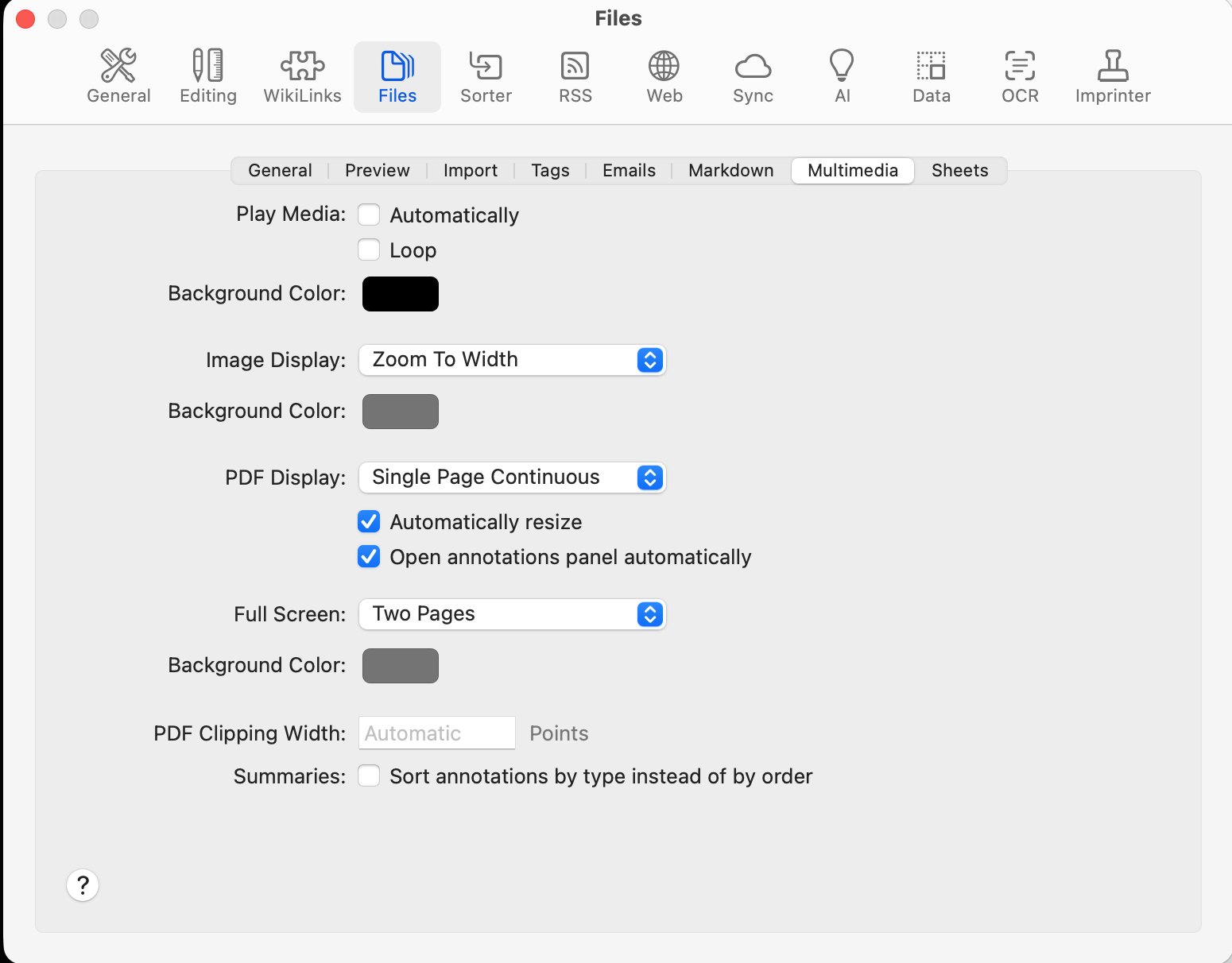

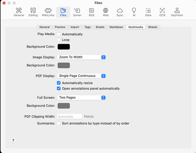

What are the Settings > Files > Multimedia settings in DEVONthink?
Set PDF Clipping Width to 612 and try the clipping again.

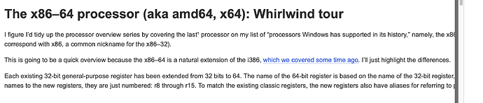

I set it to 612 and clipped the same page again, unfortunately the result looks the same as before. I tried restarting DT but it made no difference.

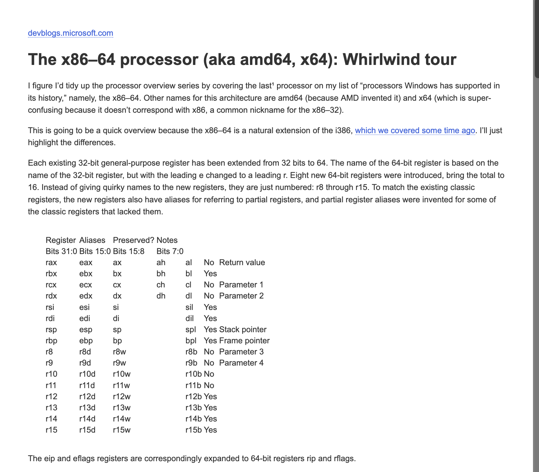

I just clipped this page successfully on 26.3 using the same settings:
