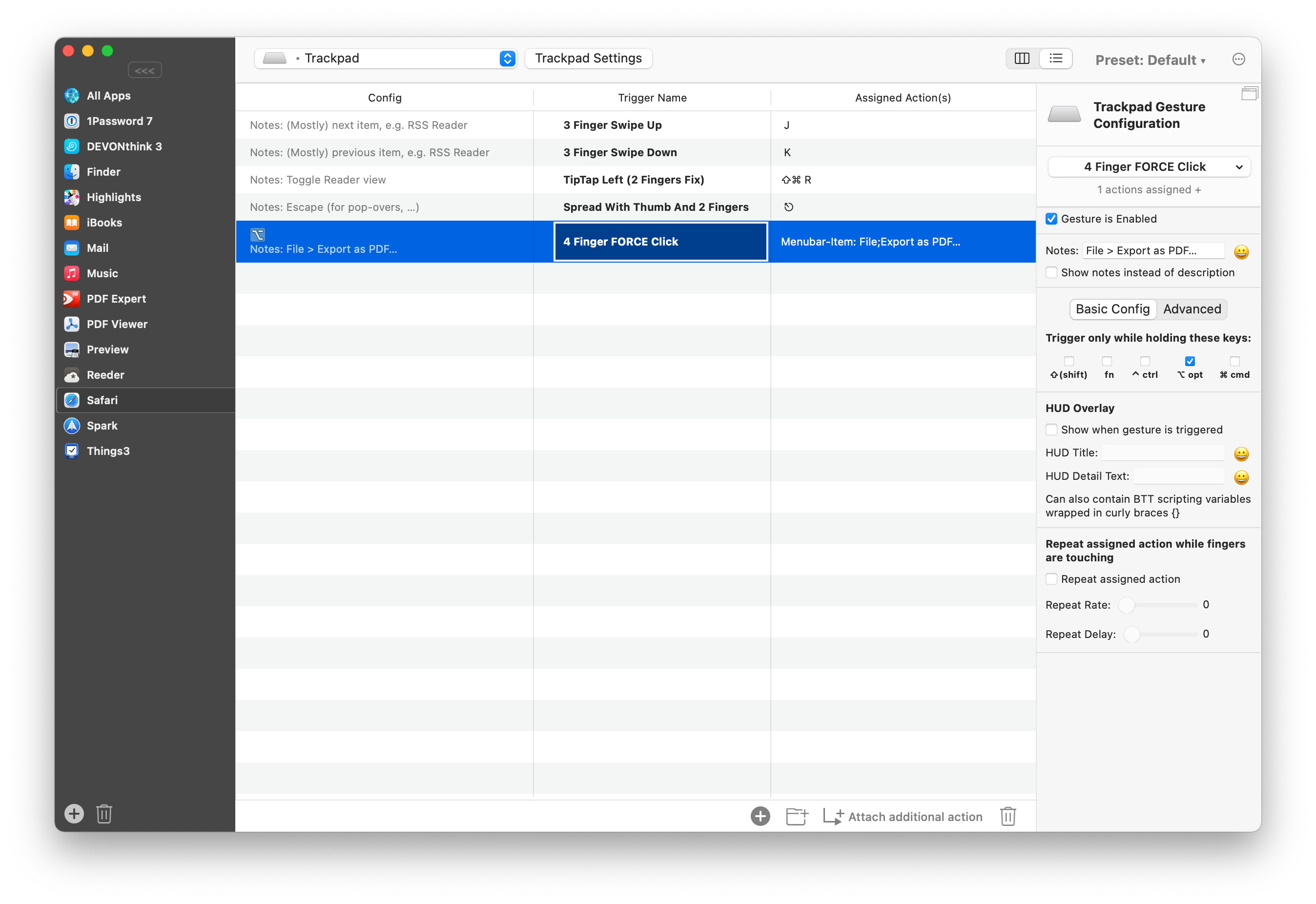

I also mostly skip the DT clipper because of unpredictable results and like using Safari’s Export to PDF option. To make this simpler, I use Better Touch Tool to invoke it.
Then the save dialog defaults to the DT Inbox via the Finder sidebar favorite.
So it’s practically 1 trackpad gesture and pressing return, to clip any page.
