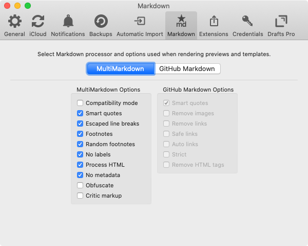

To prevent this some Markdown apps have options on how to treat MMD meta-data. Be it a general ācompatiblity modeā (i. e. just basic Markdown) or a more elaborate solution of turning on and off the rendering of single MMD features. See Drafts (screenshot below), Marked, or Fletcher T. Penneyās very own MultiMarkdown Composer.

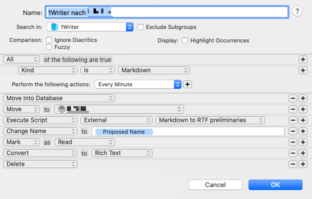

And to everyone else who might be interested in de-metadataing the MMD metadata here is what I did: I simply replaced every : in the Markdown file by \\:. With this Smart Rule script:
set theText to plain text of theRecord as string
set theText to my findAndReplaceInText(theText, ":", "\\:")
set plain text of theRecord to theText
end performSmartRule

DEVONthinkās current MMD engine displays the \: only as : in the rendered Markdown file. Marked, for example, that works with MMD displays them rendered as-is.
And thatās the first restriction, at least for those who want to keep the MMD file in DEVONthink. The alleged metadata is automatically converted into data and the rendered file looks fine in DT. But not necessarily in other Markdown apps because of possibly visible backslashes.
Since I want to convert the MMD files into RTF files that does not matter to me. To compensate, the second restriction applies to me: Since adding the execution of my āMarkdown to RTF preliminariesā script to the Smart Rule it does not delete the MMD file anymore so in the end I got both it and the RTF file.
Any idea why the deletion does not work anymore? I have tried different positions of the script execution in the Smart Rule already but without effect.

But here it is different: Before my script was in the Smart Rule āDeleteā removed the old file and just kept the new. Now with the script in the Smart Rule āMove to Trashā removes the old file and keeps the new. Iād love to know why.
Usually a harmless message and just for debugging. In most cases this is logged by background tasks which canāt access a file as itās currently in use (e.g. by AppleScript, the user or another background task). But automatic retries will be performed anyway.
Before the script to replace the colons by backslash-backslash-colons in the MMD file was part of the Smart Rule it worked fine with āDeleteā as the last step: RTF file was there, the source MMD file was deleted. After the Script was in the (beside that unmodified) Smart Rule āDeleteā did not delete the MMD file anymore. But āMove to Trashā worked and moved it to the trash.
