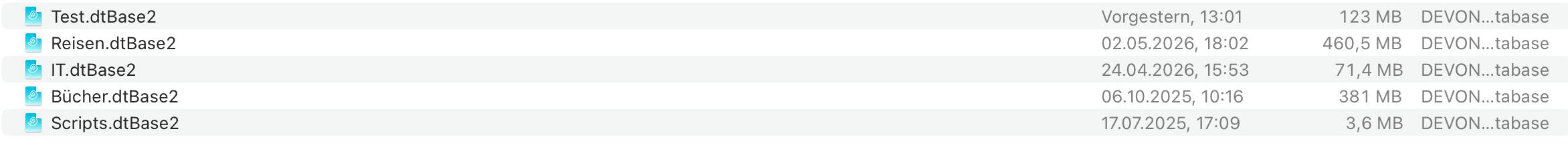

Can you provide a screenshot of those? Although I have only imported files, I never see a DT 3 document type in my DT databases. Finder only uses this icon for databases, it seems.
This is with DT4, though.

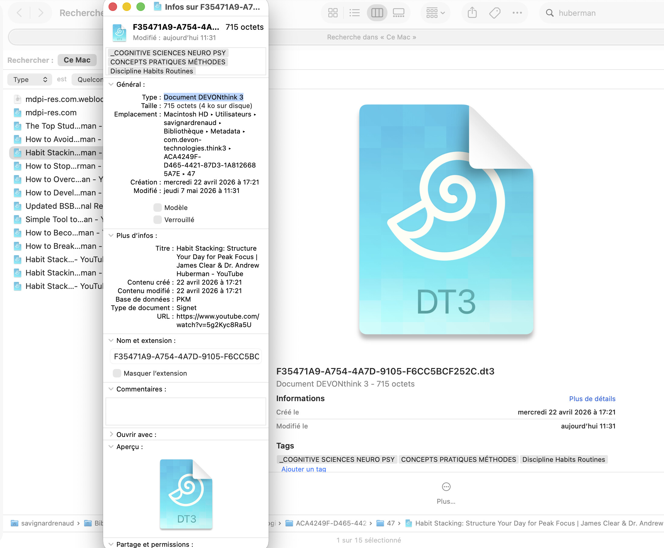

Yes of course :
What even makes you go into this folder? It is (and for good reasons, apparently) hidden from the usual Finder display. And the data inside it are DT internal metadata that you are not supposed to even know exist. Much less think about “converting” them.
For the not French speaking readers: The files are located in ~/Library/Metadata/com.devon-techonlogies.think3.
Back to your original post:
If you have indexed files, they are not “in” the database. Only imported files are “in” a database. Indexed documents in DT have a special icon indicating that fact.
What you see in ~/Library/Metadata/com.devon-technologies.think3 will certainly not appear in your database if you look at it in DT.
You never open anything “in Finder” – Finder is just a nice interface. You double click on a file and the associated program opens it. Which you can do exactly in the same way in DT: set “double click opens in default app” in its preferences. And you do not have to worry about importing vs. indexing, nor about weird icons.
TL;DR
DEVONthink is an abstraction layer. Like Finder. It uses metaphors (like Finder) that help you interact with bits and bytes on your disk. If you start hunting around, you will surely find information used by Finder internally, as you just found information used by DT internally. Leave those alone. Don’t even think about them. Just ignore them. Apple made it intentionally difficult for the uninitiated to even see things they do not understand and should not touch. Do not circumvent these safeguards by making hidden files visible or using “Go to Library” from Finder’s menu or the Cmd-G shortcut with ~/Library. If you have turned on “Show Library folder” in Finder’s preferences, turn it off again. Don’t let yourself be tempted! Stay pure!
Those are Spotlight metadata files. They are not files inside your database. And @chrillek is correct: you shouldn’t be messing about in the Library directory or in the internals of a database.
OK, I get it, thank you for your detailed explanations.
I had left activated hidden files view (“Command+Shift+.”) -I did this for another purpose.
I had made some research in the DT help files before posting, but of course did’t find information about these files as nobody should see nor handle them.
I understand now these mysterious files are metadata, not kind of invisible imported data I would have to convert back to their ‘normal’ I Indexed & Finder visible state :man_genie::zany_face:
