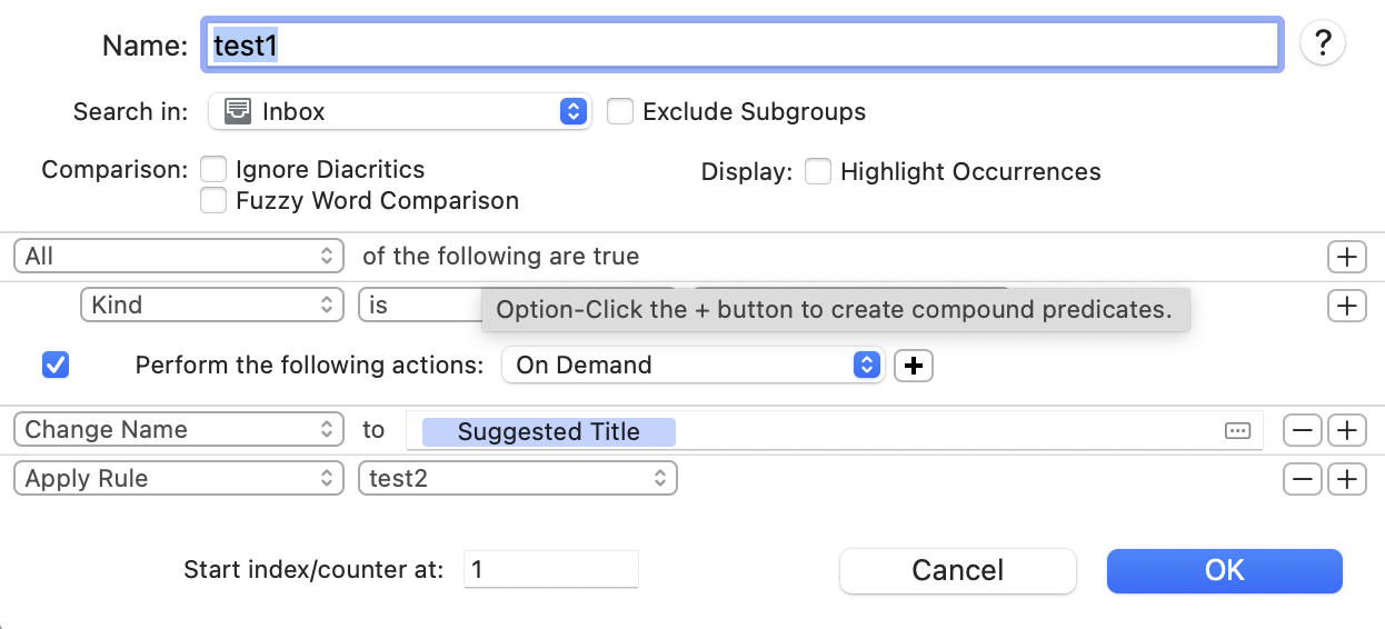

I found a bug in DEVONthink’s automation: If a rule contains an AI operation and it’s used by another rule that also has an AI operation, it can’t batch process files. After handling the first file, the automation process crashes. Here’s my test rules:
and

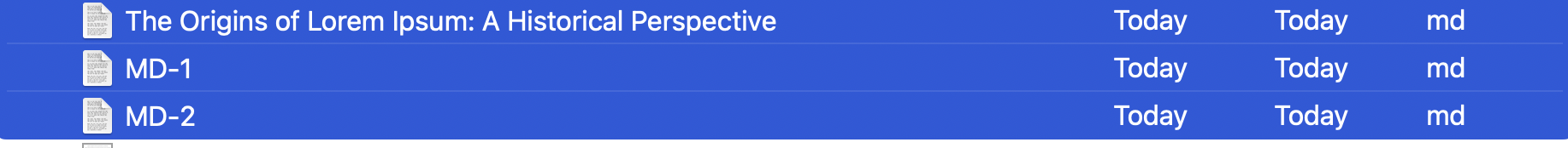

Three md files with random texts are used in test. Only the first one is renamed.
