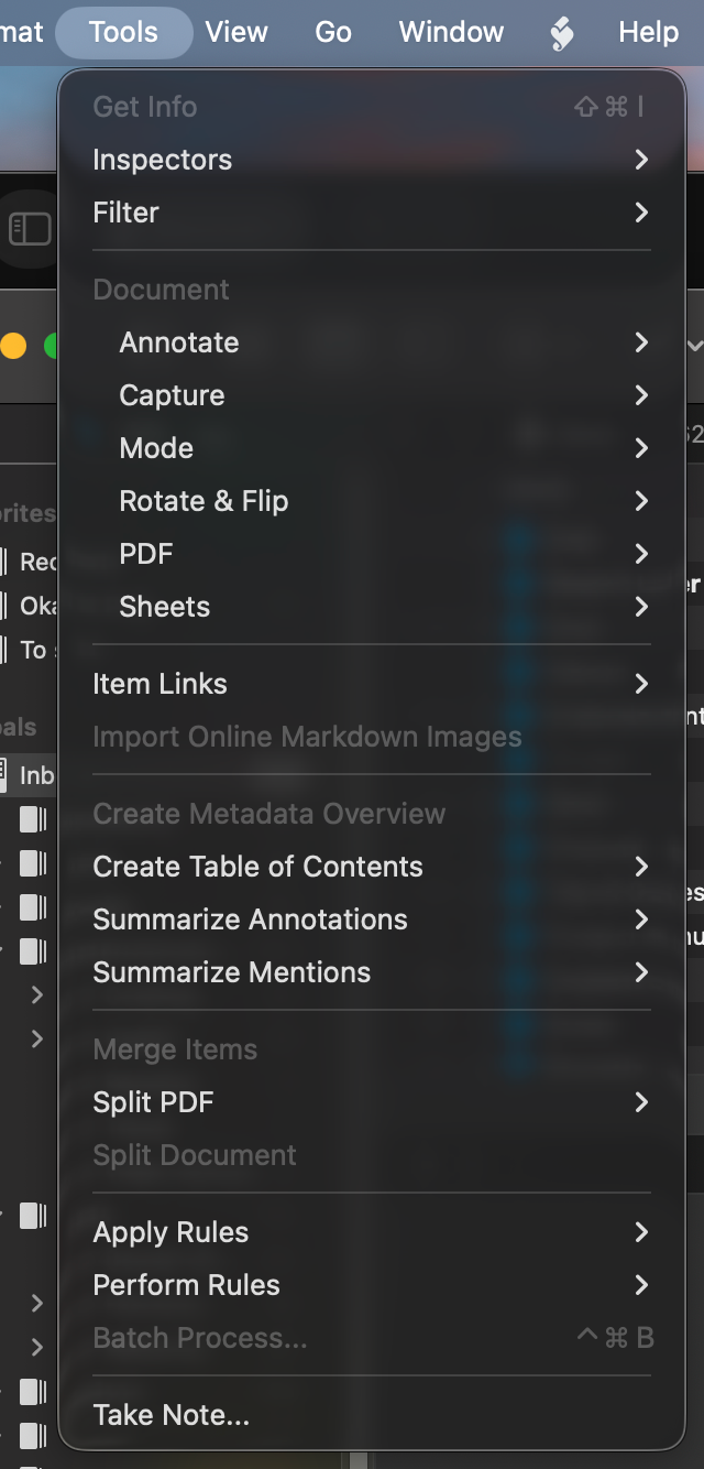

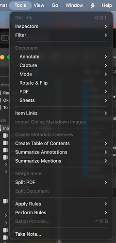

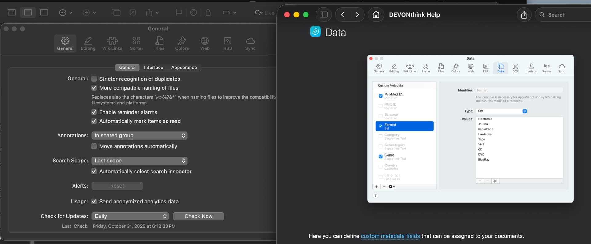

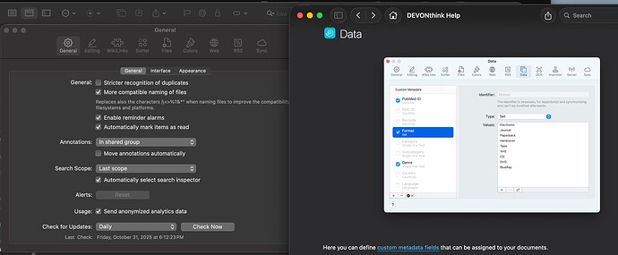

A screenshot of Settings > Data and of the Tools menu would be useful.
Sorry for the delay… crazy couple of days. Here are the screenshots :
Funny thing the data section is not there… I know it used to be though…
Thanks

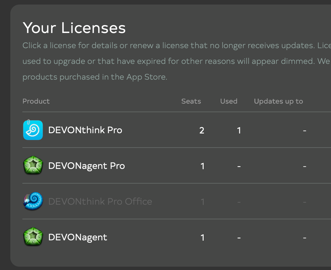

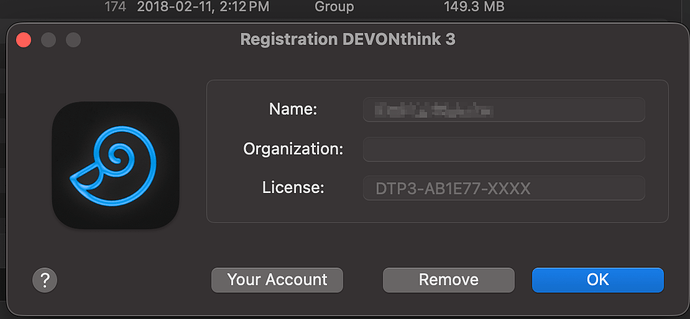

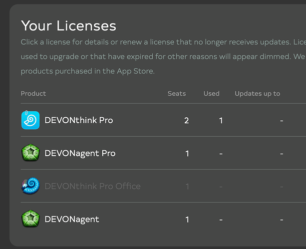

According to your screenshots you registered the app with a license for DEVONthink’s Standard edition (prefix DT) but not the required Pro (DTP) or Server (DTS) license.

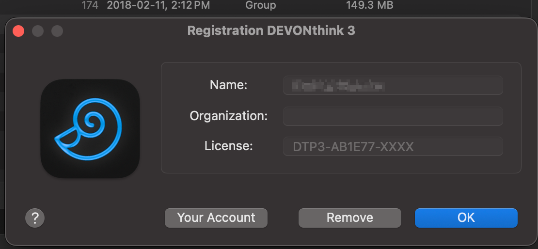

Yeah it’s weird… It does register as Pro (I don’t have standard).
When I’m pretty sure that when I register it says Pro on the activation window in the app, but I soon as I close and reopen, back the Pro no longer show Pro… Now I can’t do it anymore as it says it was registered less then 5 days ago so I can’t remove registration for now…
As you can see the liscence is start with DTP :
