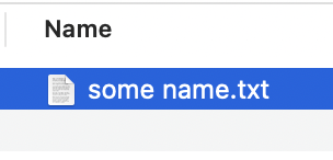

Much simpler with a strictly conforming name…
Original
Tools > Batch Process
Result
While a smart rule could be employed – and use the same actions – it would only be necessary if this is a process that would need to be repeated in the future in a more automated fashion.
