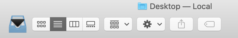

What I observed: why not consider drag and drop the DT3’s Finder add-in of Inbox to the macOS Dock like this?
Anyone can just drop anything into DT’s global inbox without opening DT3.

If you are referring to the dock alias…
  1. In the Finder, select the ​Go ​menu while holding the ​Option key​, then choose ​Library​.
  2. Go into the Application Support/DEVONthink 3 directory.
  3. Drag and drop the Inbox folder (not the .dtBase2 file) onto the dock.
PS: If you’re so inclined, you can Command-drag the Inbox folder to the toolbar of a Finder window too :slight_smile:
