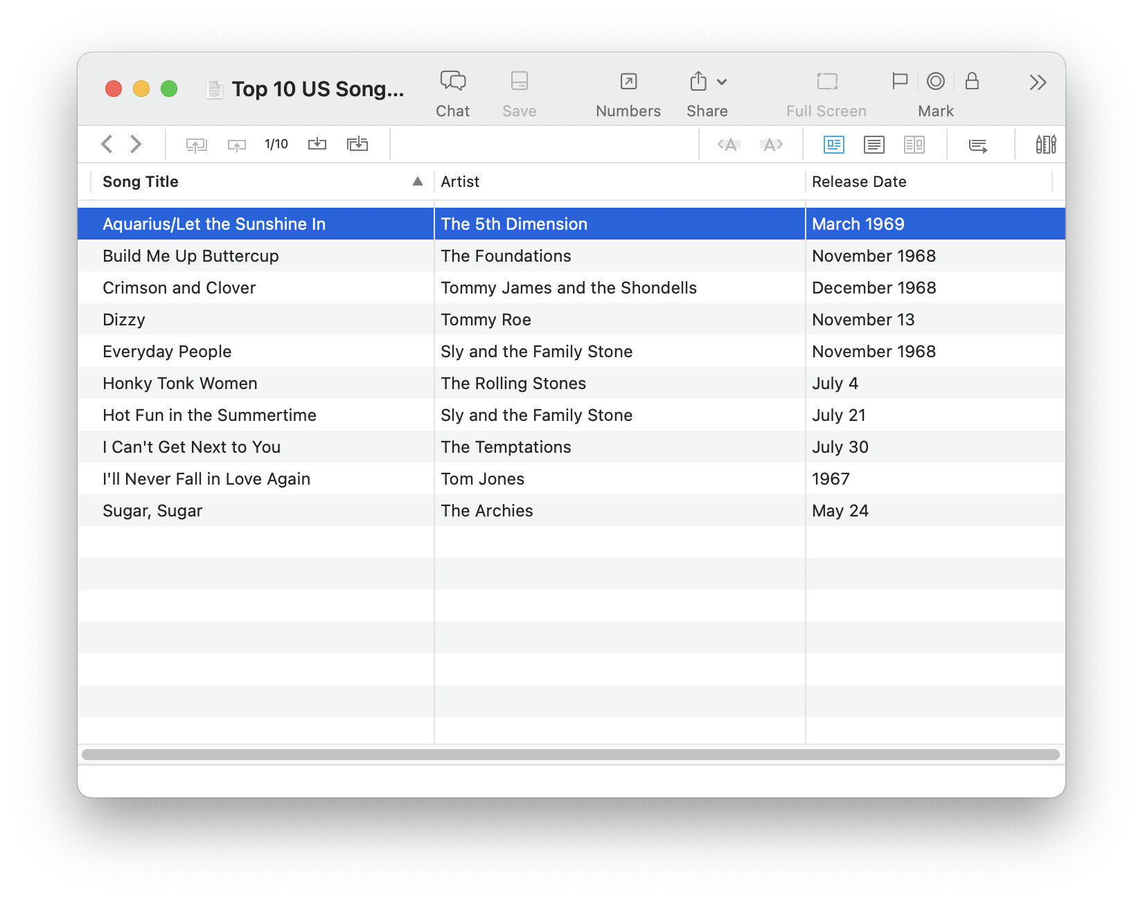

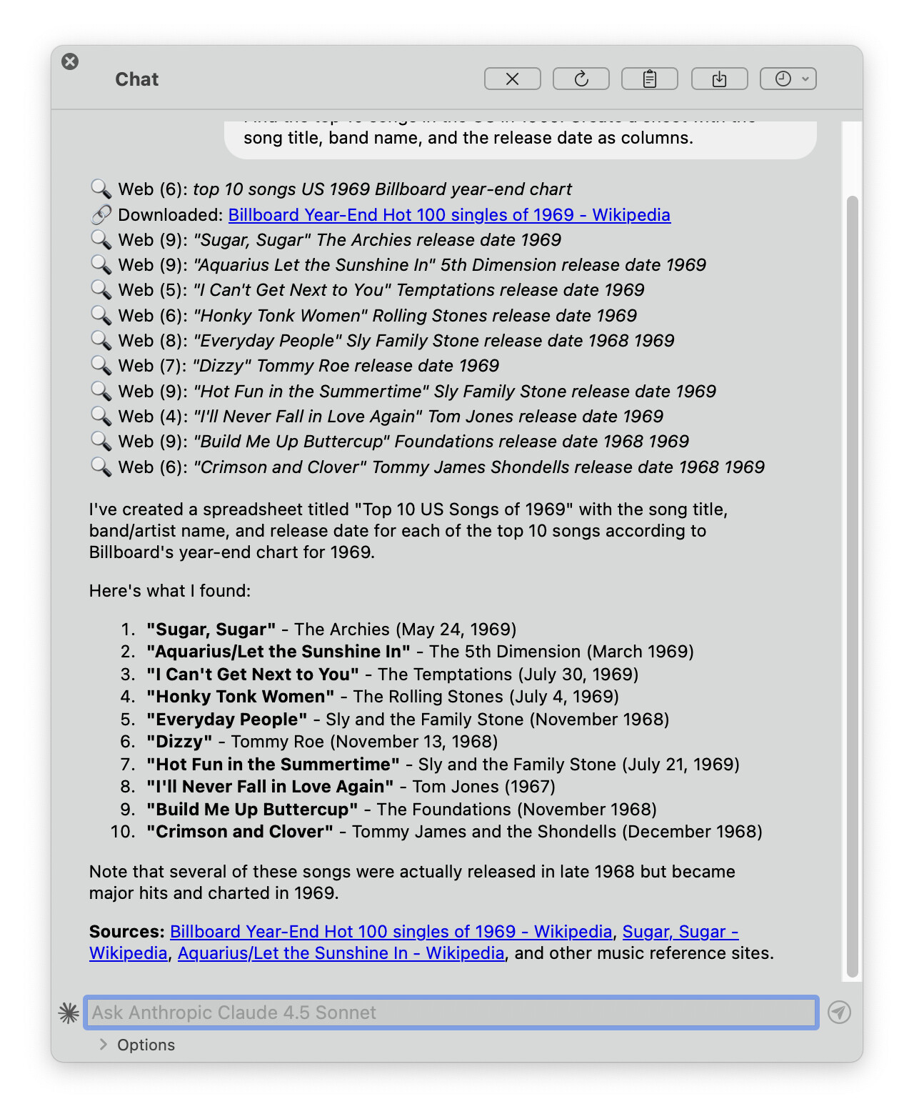

What is your prompt?
I just ran a simple query with Claude Sonnet, specifically asking for a sheet…

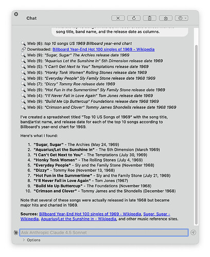

Please send the file ~/Library/Application Support/DEVONthink/Chat.log to cgrunenberg - at - devon-technologies.com so that we can check whether it’s an issue of the app or of the AI’s response. Thanks!
