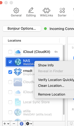

In addition to @bluefrog pointing out the location in Help (same as in the “DEVONthink Handbook”) here is a screen shot. Lots more great info in the outstanding “DEVONthink Handbook” (same content in Help). “Right Mouse Click” on the selected sync location.
Thanks for the information. I didn’t have any idea that was there, Ctrl + Option clicking sync locations to verify them thoroughly. For what it’s worth, the process ran to completion with the log window containing the message “Location successfully verified.” and nothing else.
