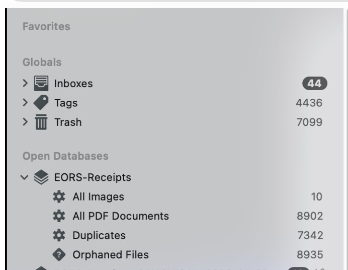

Do you remember what kind of error was reported? Are these new records located in the group Orphans? If that’s the case - are some or all of them duplicates?
Here is a screenshot. I think I know what happened. Inadvertently, the database file ended up being mirrored to an external hard drive and at some point Devonthink must have assumed that that was the primary copy. Some kind of replication error must have occurred. My choice now is to use a backup copy and lose a lot of work or to try and salvage this. Any advice would be greatly appreciated. The correct number of records is somewhere around 2800. Thanks!
