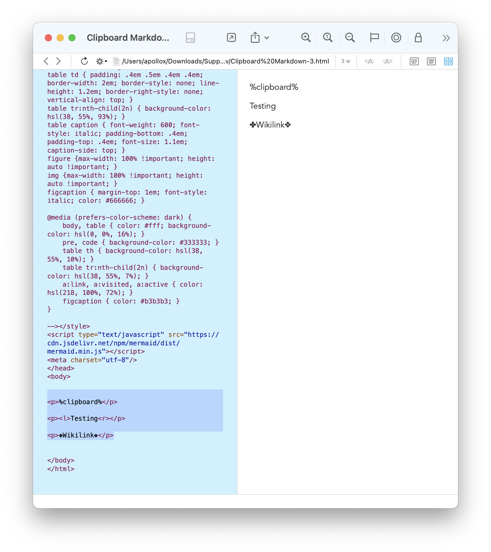

But you’d end up with ✤Wikilink❖ in your converted document. :thinking:
Following your example, I’d suggest converting the brackets to an empty HTML element, e.g., [[ to <l> and ]] to <r>.
