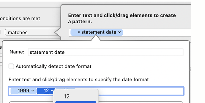

How is customdate defined in Hazel?
There is the smart rule action “Scan text” that takes different parameters, also regular expressions. Difficult to tell you what to do if you don’t show how customdate is defined.

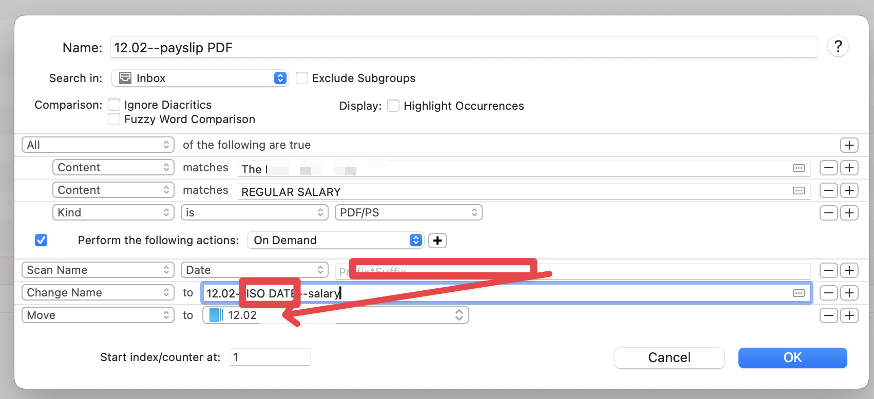

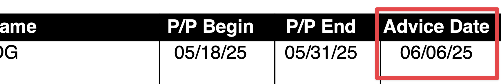

lets say i have this

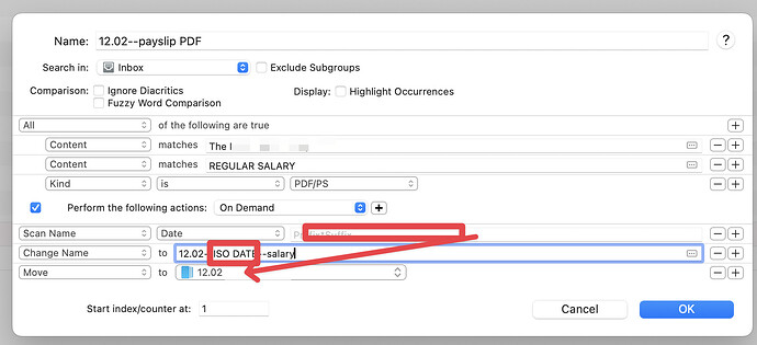

which regex/scan method can i use to get the date of whats under advice date and then how does one use that in the smart rule as a ISO date, ie

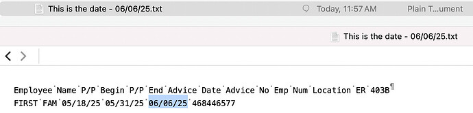

This depends on the actual text layer in the document. What you see and how the underlying text is structured is not necessarily the same. Also, the text layer can vary based on the operating system.
Select the PDF and choose Data > Convert > To Plain Text. Examine the plain text to see where 06/06/25 occurs.
Well, what did you do in Hazel to make it find that? Hazel is working with the very same underlying text, so you should use similar patterns in DT.
If the date follows the ‘Advice Date’ string in the PDF’s text (see the post of @BLUEFROG), you could use Advice Date* in your Scan Name Date action.

seems like after converting to text the actual dates are in another line below
Employee Name P/P Begin P/P End Advice Date Advice No Emp Num Location ER 403B
FIRST FAM 05/18/25 05/31/25 06/06/25 468446577
should i use a regex for the 3rd occurrence of date in

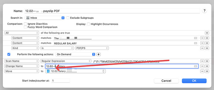

hmmm so played with regext in the scanned document
how does one refer to what was found as a variable when you go over to rename?

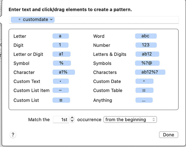

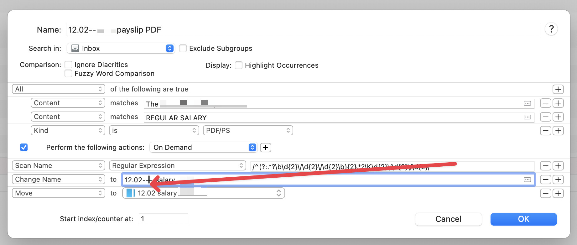

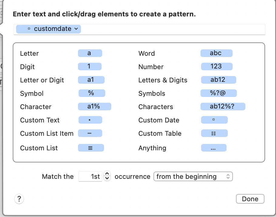

here is how its defined in hazel
where in this case its matching on the 1st date (via hazels gui) but for other rules its matching on 2/3/or even 4th occurrences

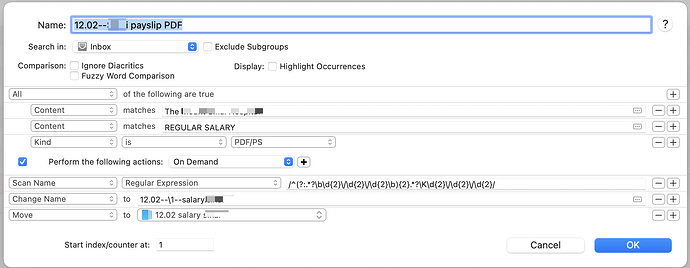

also here is the full regex in text in case thats needed /^(?:.*?\b\d{2}\/\d{2}\/\d{2}\b){2}.*?\K\d{2}\/\d{2}\/\d{2}/
still unclear to me how the scanned texted can be used in the rename part

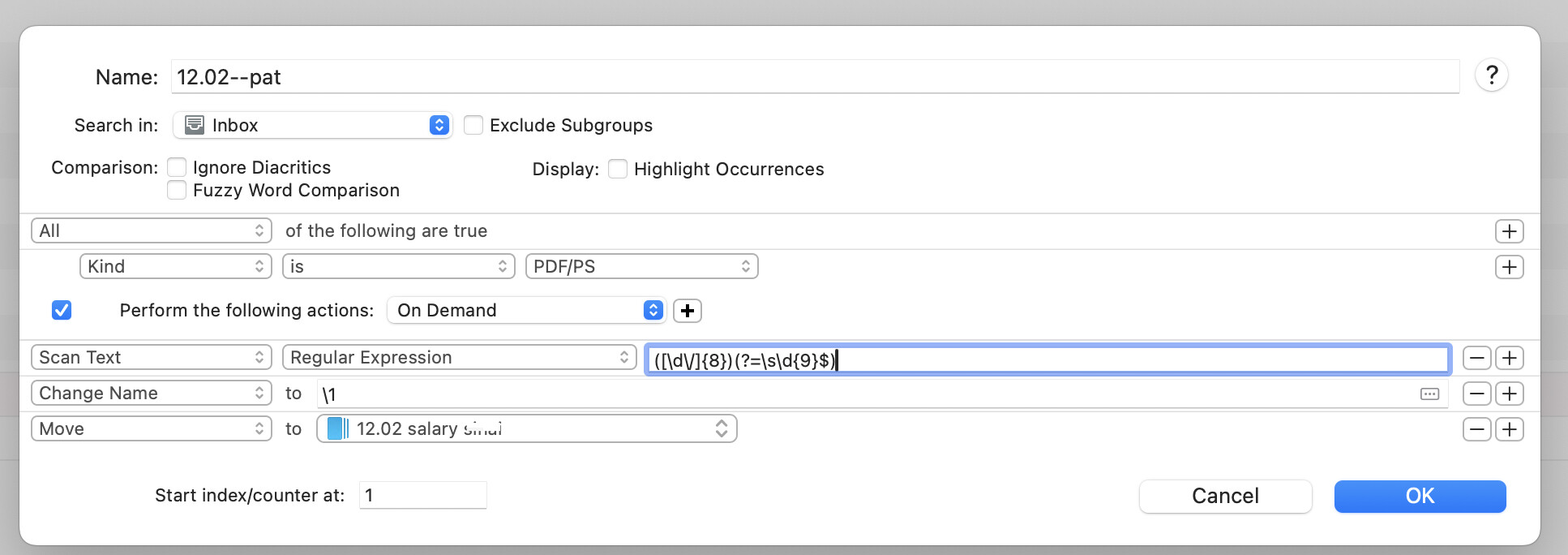

For this particular document, try ([\d\/]{8})(?=\s\d{9}$) to capture the date as shown. If sufficient, that should likely work with other such salary documents from the same source.
You would then use \1 in subsequent actions.
That’s not the definition, but the dialog used to define it. Something like this would have been the definition:
Anyway, let’s start with the RE:
I’d try something like this instead
/(?:\d\d\/\d\d\/\d\d\s+){2}.*?(\d\d\/\d\d\/\d\d)/gm/
I’m not sure if the enclosing slashes are needed, though.
In any case, that defines a capturing group (the last sequence of \d\d\/s). And you refer to that capturing group in the “Change Name” action as \1. As describes the documentation:
Regular Expression: Items in parentheses are captured; items outside parentheses are ignored. You can specify multiple captures in an expression. Using the captured text in subsequent actions is specified by using backslash, \ , and the number of the capture, starting at 1 . Note we use Apple’s NSRegularExpression which supports the ICU regular expression syntax.
I have no idea what the \K in your RE is about, so I left that out. I tested the RE with regex101.com and it seemed to work as expected.

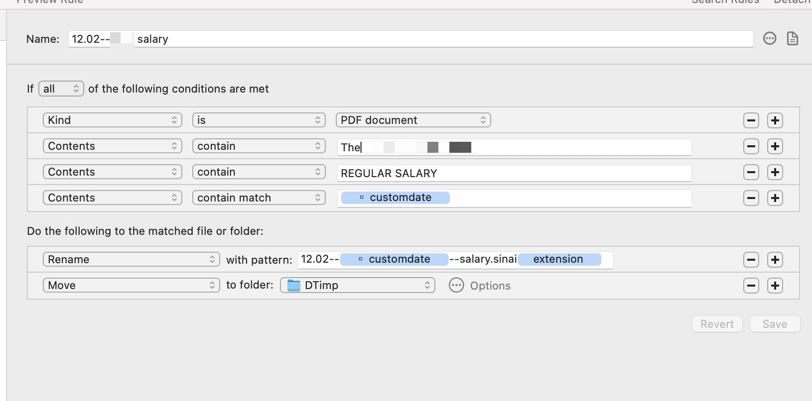

does not seem like the smart rule actually renames the file. i tried both you guys regex syntaxs and in both cases it just moved the file without any renaming
this is the current smart rule state, am i missing anything in my syntax

Mine worked as I said it would…
You use neither of the REs that @bluefrog (which is better than mine, provided that your date is always followed by a space and nine digits) or I suggested. So, yes, you are missing something.
I suggest you slow down a bit. Perhaps having a read of the manual, of all the posts and then take a look at your smart rule again.

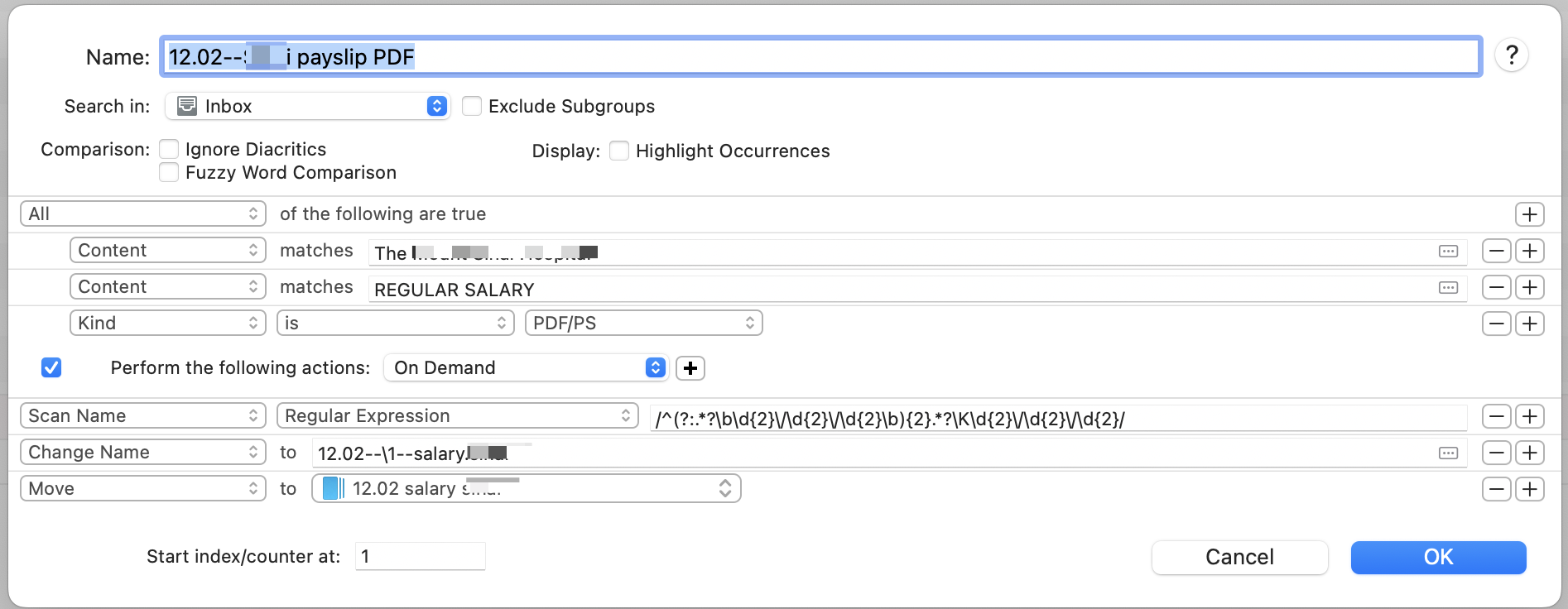

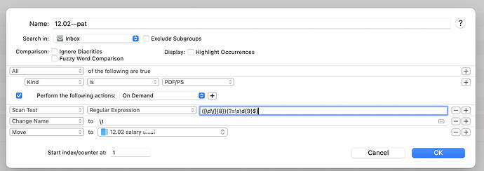

i did of course try with multiple RE’s before without sadly any success. i even tried 1:1 what @BLUEFROG suggested
i also tried running this over a text file
each time the file is just moved as is without any renaming to the target folder..
happy to further debug if im missing anything. for sure will keep reading the documentation and posts. worst case ill just leave it be with hazel
