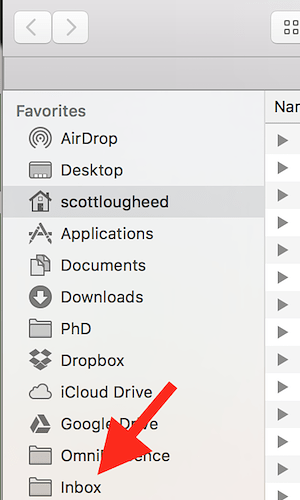

by default, installing DEVONthink will also create a folder called “Inbox” in your finder sidebar (See screenshot). This is accessible from all “save” dialogues.
Saving a file in this “Inbox” folder will result in the file being added to your Global Inbox in DEVONthink.

Hello Bluefrog,
I have been asking myself the same question and before posting it here I searched after the answer and saw yours. The thing is, I just don´t the folder in my finder. Not even if I want to addapt my side menu, please see screenshot. Do you have any idea of what the problem could be? I would be really greateful since this is so annoying.
Br,
Milos
Replying to myself, I have restarted my Macbook and it worked! The folder is there. Perfect!
Excellent. For benefit of others who might forget, the request to install is on the Menu: DEVONthink 3: “Install Add-ons” dialog box.
