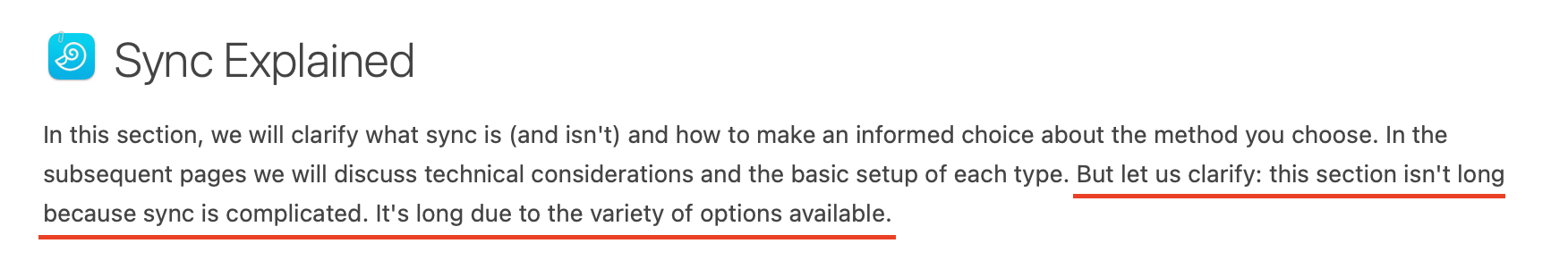

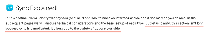

Sync is not complex at all. In fact, it’s quite simple, philosophically and technically. See the In & Out > Sync Explained section of the aforementioned Help, with this specific note…

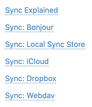

One of the major structural changes I made in the DEVONthink 4 documentation was to consolidate and distill many of the posts and replies I’ve made over the years into this section. I also split out each sync method into their own sections…
Take the word of a former marketing guy: when you have to write a summary article because you offer a user five different ways to do the same thing, it’s a complex choice for a user to understand and make—especially new users.
Your point?
From the many posts here, we learn that people seem to have their own preferences (which are not the same) including preferences for sync methods which are not known to work. Oh well.
Bluefrog literally just said it’s “not complex at all”, which is clearly false. I’m a long-time user. I appreciate the options and mostly (?) understand them. But I don’t think it’s helpful to kid yourself or put users off by telling them the thing that is complex isn’t complex.
