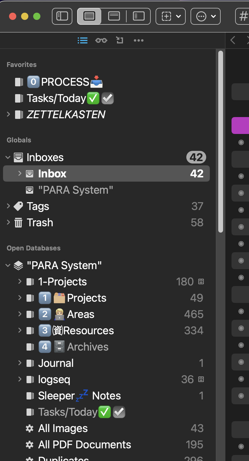

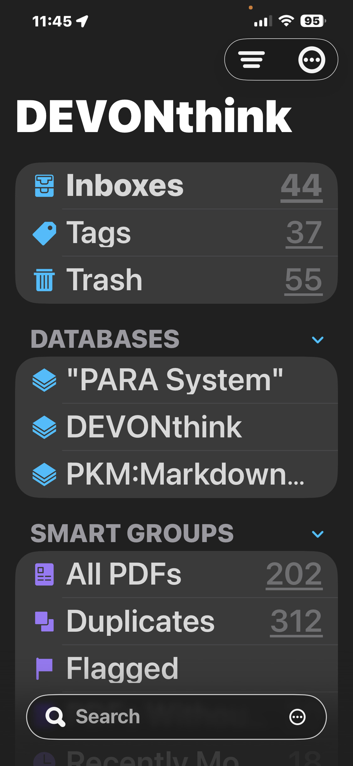

I cannot see the same view between DT vs DTTG. See sceenshots
They are different applications. Why would you expect to?
You’re right! I have Zettelkasten & Tasks/Today folders on DT-OS. But I cannot see them on iOS- DTTG
Your DT screenshot is showing the groups under Favorites
In DTTG you can scroll down to see your Favorites under Smart Groups
Did you add the groups to DTTG Favorites?
The favorites aren’t synced between apps, if that is what you’re referring to.

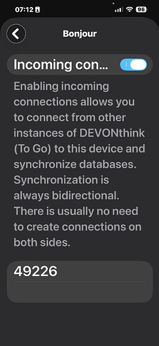

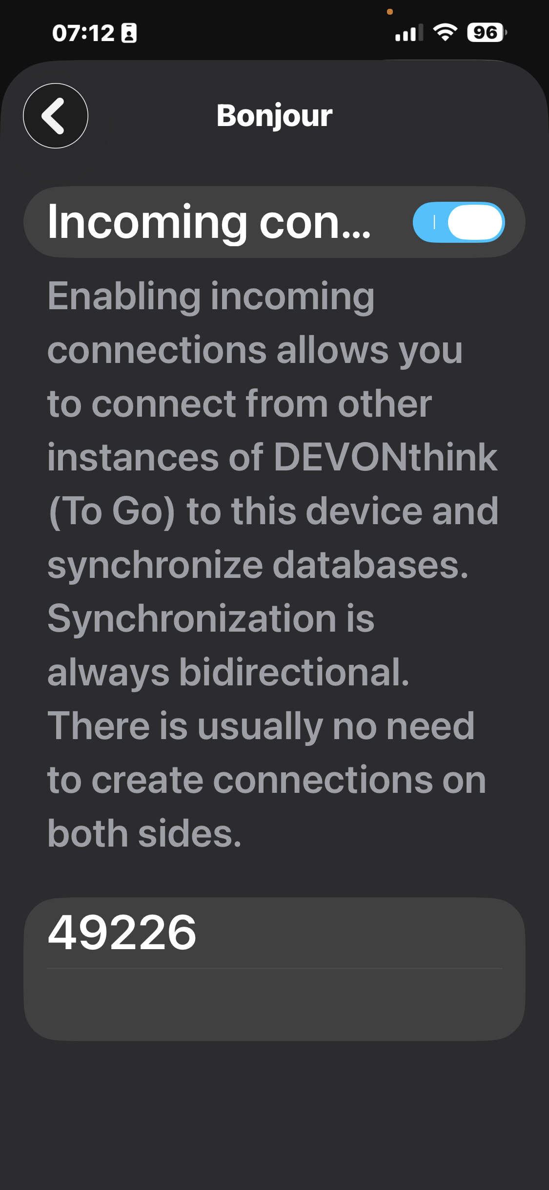

What change did you make?
The switch was not turned on. Turned it on, and good to go. Again, thank you for all your support!
Bear in mind, flipping that switch makes DEVONthink To Go into a Bonjour server. While this is not typical, you want to make sure you don’t have more than one device acting as a Bonjour server.
See the Sync: Bonjour section in the In & Out (DEVONthink) or Sync (DEVONthink To Go) chapters of the built-in Help and manual
I disabled the connection to Bonjour on my iPhone. Everything syncs!
