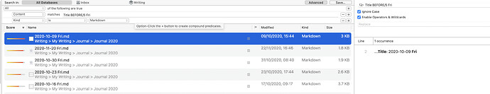

Is internal metadata searched for or not? There’s a suggestion up thread that it isn’t, but I seem to be able to do it fine. This is a search for journal entries on Fridays…
Is that because I haven’t (knowingly) rebuilt this database? Or is metadata in fact still searchable?

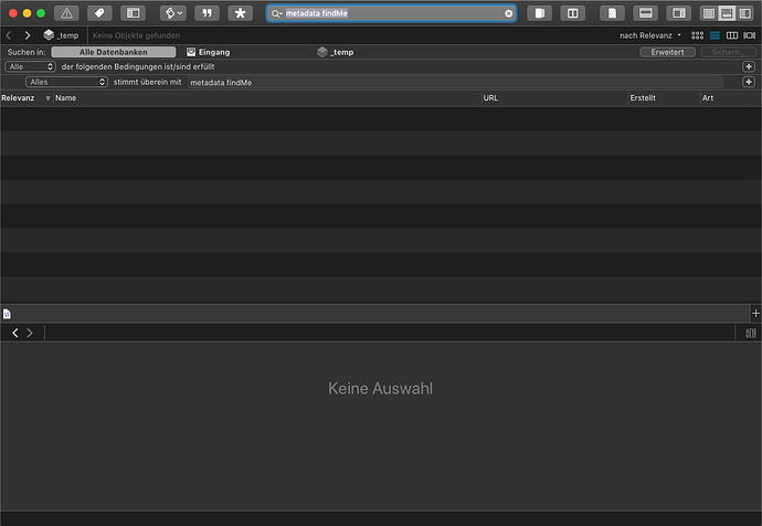

I can’t search metadata since DEVONthink 3.5.1.
metadata: findMe
### Test
Text

But metadata is indeed currently not indexed like links.
No problem, you can be sure that I’ll point out that it is not searchable

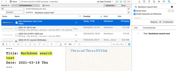

But I can search metadata, even with a file created today with the current version.
Note how the search term is highlighted in both the text and the Find inspector.

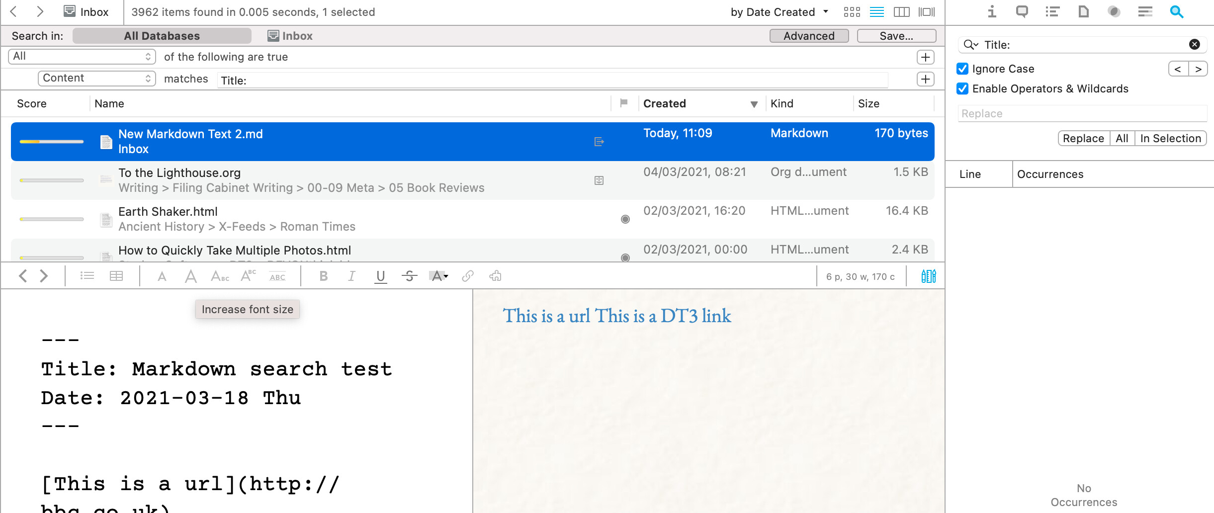

But if I search for Title: , either on its own, or as Title: Markdown search test, the document is still found but the search terms are not highlighted.
I feel a bit confused, TBH…
A search for text:x-devonthink-item doesn’t find it as expected as the URL is not part of the indexed text. However, item links are internally indexed too (also in case of PDF, text, RTF or web documents as this is e.g. necessary for the Document > Links inspector) therefore just x-devonthink-item finds it.
However, in case of e.g. [Apple](https://www.apple.com) the search won’t find the URL of the link.
