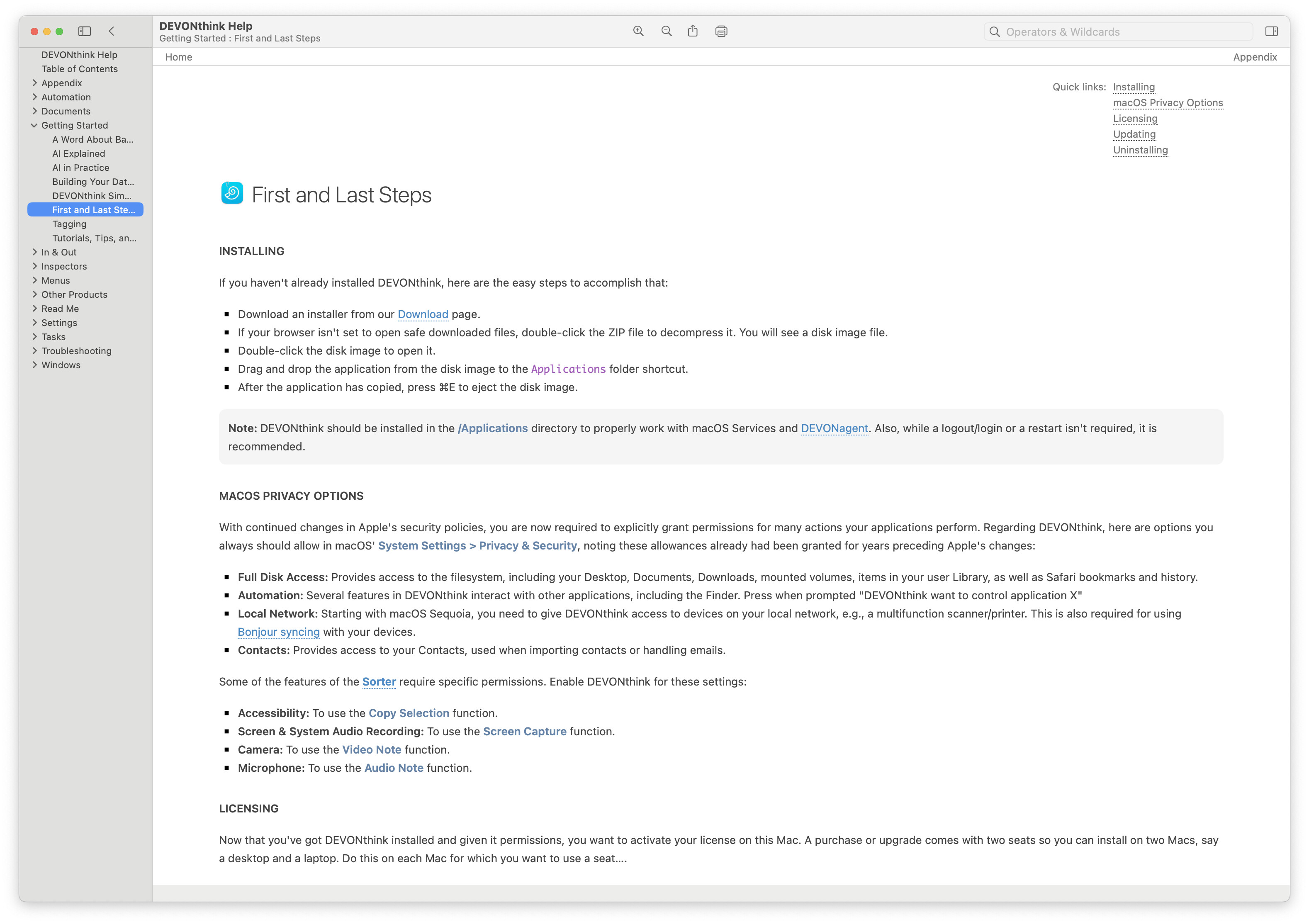

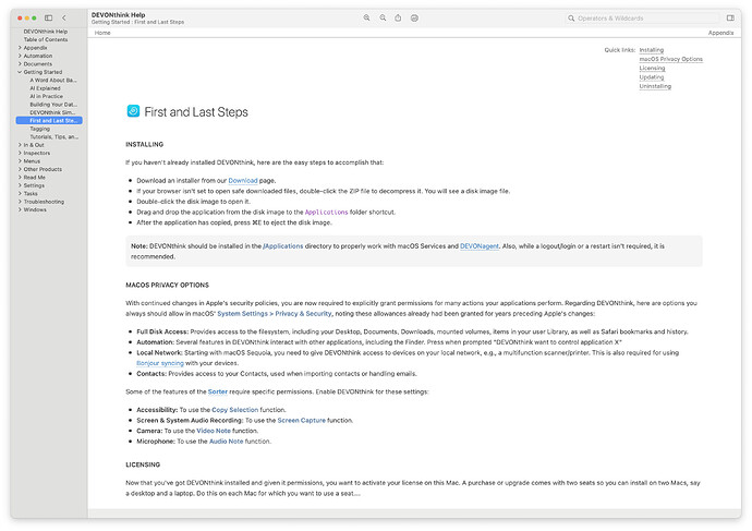

FYI…
PS: For the next release, I have added the missing Allow button on Automation and also clarified Local Network is for local WebDAV services as well.
