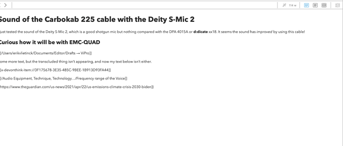

Still there is something wrong. I’ve now transcluded a document in the Finder with the path. Here’s a screenshot.

Well, in another attempt I used the item link; see screenshot.

Full filesystem paths need an extension, only relative/absolute links inside the database don’t need them.
Is it possible that Hook sits in the way of this new feature?
I’ve just played with this; for me it works with x-devonthink-item links, and using the name (w/ or w/o the extension) of a file in the same location (in my test the root of a database) as the md file. It also worked when I provided a path to a file within the database. In my tests I used plain text files. It does not work for me with links to external files.
