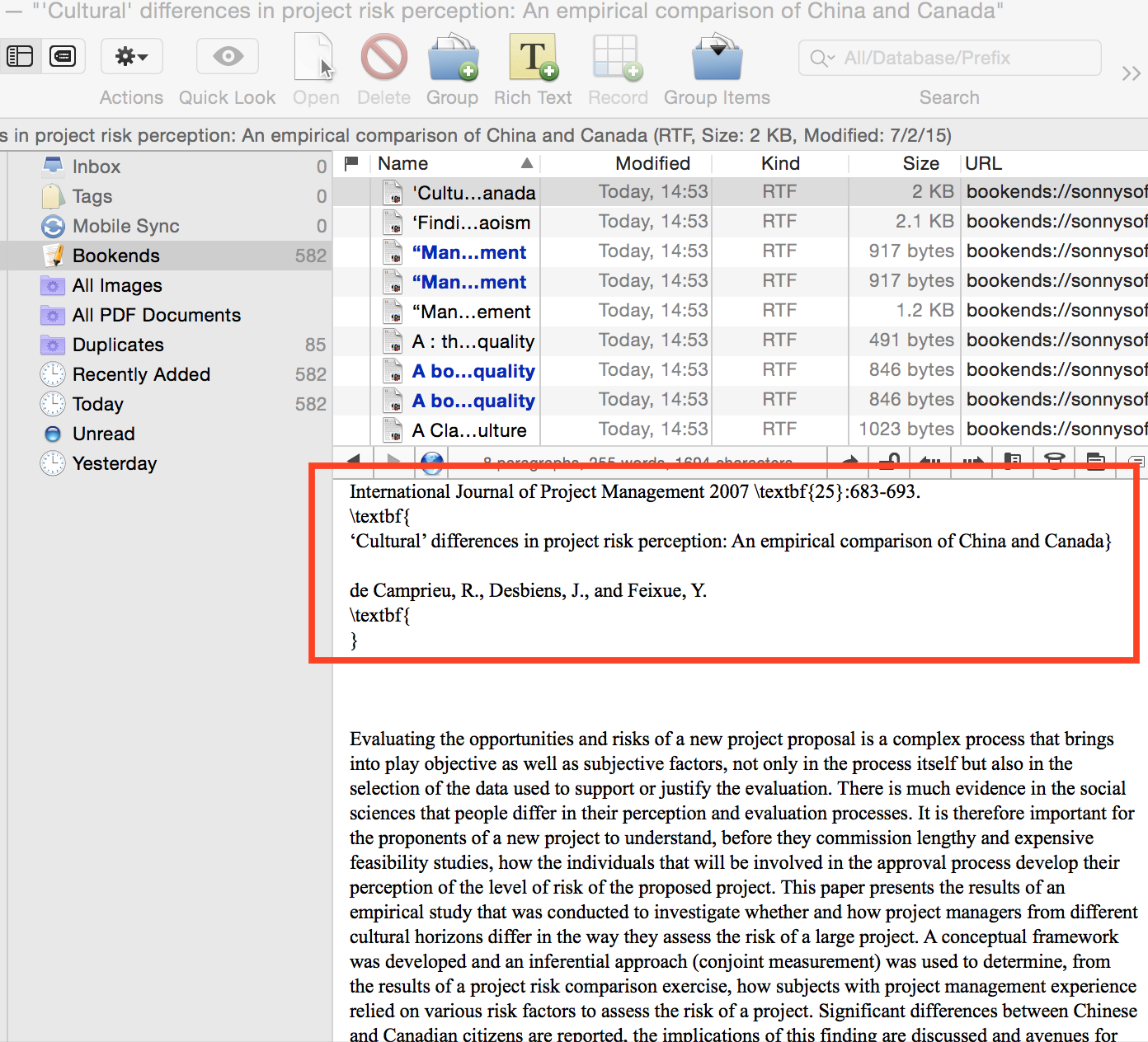

I have imported all my current references from Bookends, and tried it a few times, but the .rtf files always end up looking as shown in attached image. It seems to me that the files aren’t really displaying correctly (see all the {, }, etc.), could that be?

The attached image is unfortunately missing. Which version of DEVONthink and Bookends do you use? The latest ones?

The \textbf is latex code for bold. I have a demo copy of bookends and tried to export a few references ended up with a similar result without any bibtex stuff enabled (from what I can tell, anyway).

Control of how references are styled (or not) can be set in preferences (Scan & Bib tab) and/or in Bilbio -> Bibliography. Tell Bookends to output Styled Text (instead of BibTeX) and then reimport the references. I think that should do it.
Jon
Sonny Software
Enter Bookends’ legendary support! I can confirm that Jon’s solution worked for me. I selected Bibliography from the the Biblio menu and sure enough a bibtex option was selected. Switched to MLA as styled text and set defaults. Also, if you happened to delete your previous bookends import, you must remember to empty the trash or it will not reimport your references.

thanks a lot for the excellent advise; adjusting the settings in Bilbio -> Bibliography did indeed work perfectly!
