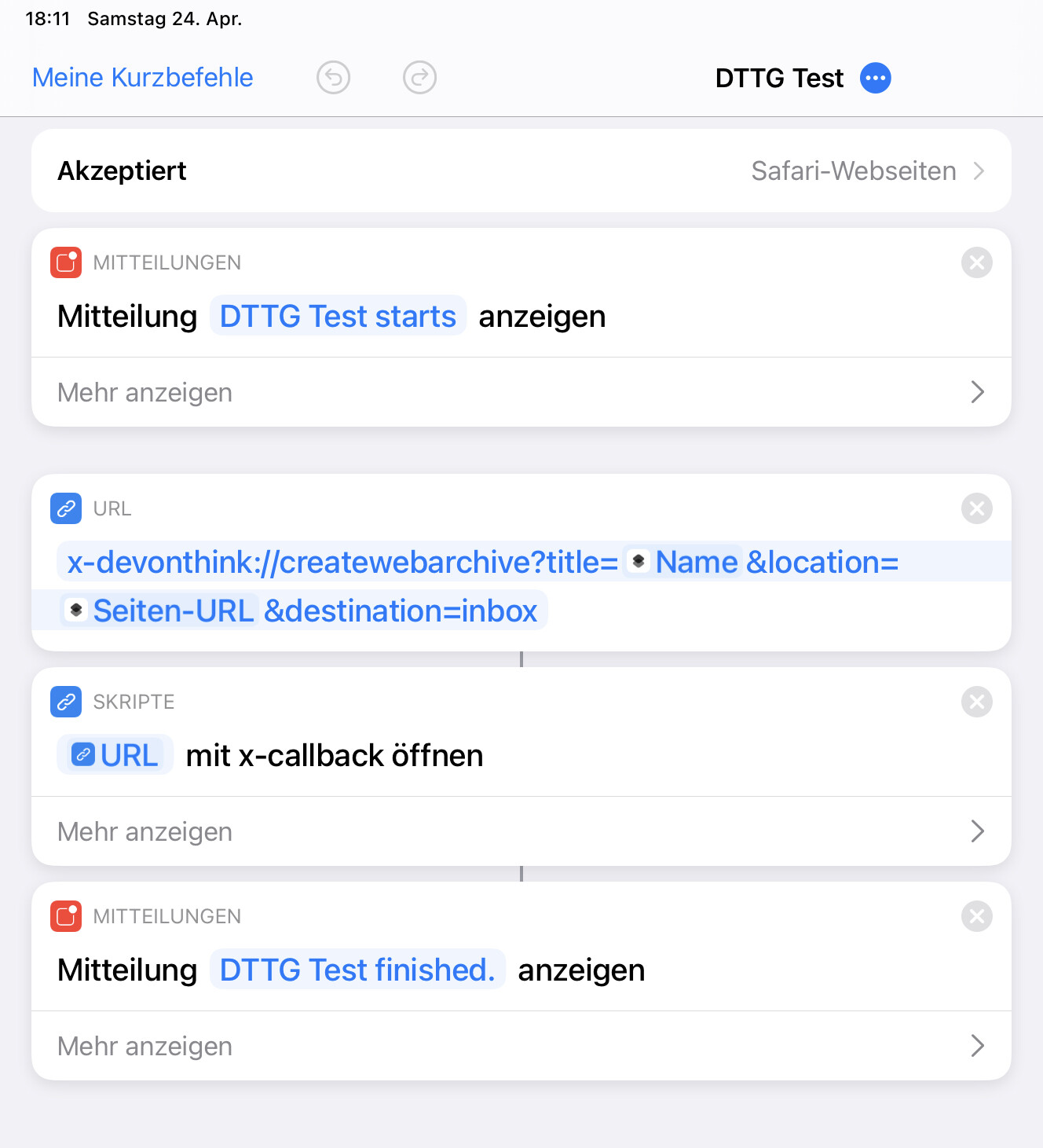

Do you see any issue with a shortcut this simple?
I tried this shortcut with Fiery and Fiery did not share a Safari Website but an URL. Is there a significant difference?
But this shortcut did not work with Fiery and DTTG. Nothing happens.
Try it with Safari.
On my first try DTTG reacts similar and opens only to crash and send a bookmark to the inbox. The next attempts did not lead to any reaction. No DTTG show up nor did shortcut react in any way.
Got same bug type und same exception type. serial.queue crashed.
Update after reboot:
First attempt with safari works fine. After that every try leads to no reaction as described before.
I added some popups and only the first one was triggered. The second one never appears. This could be the reason because there is no reaction. The shortcuts is not terminated.
