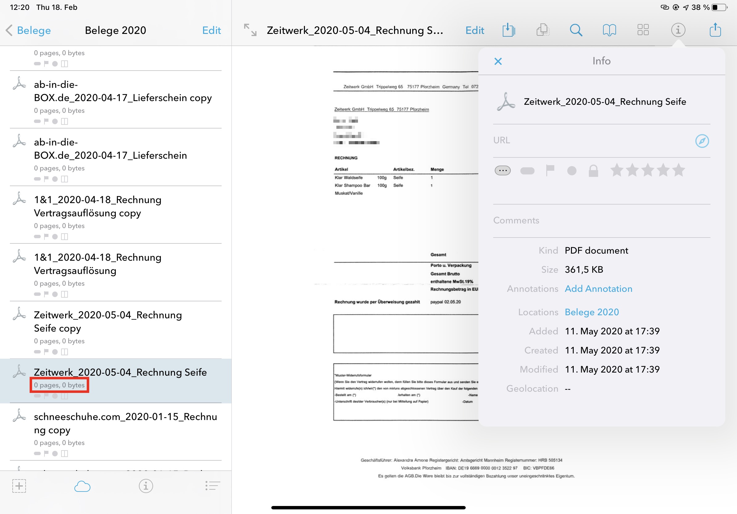

My earlier post (in short: everything’s alright now) still holds true but I’d like to report that successfully recovered former zero-byte files still being shown as zero-byte without a preview in DTTG 3.0.3. They are accessible, though, so that seems to be just a superficial issue. Also the info box shows plausible data about the size.

That’s “just” the metadata cache not being updated. We’ll fix this.
