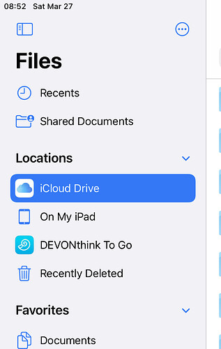

Sorry but I think you misinterpret my question. I know a green circle with a + showed up and I can successfully put the documents there as imported files in DTTG. My question is where the files (that I have put in DTTG) were saved in Files app (the default explorer app from Apple).
That’s Files.app running by itself, where you described opening DEVONthink To Go and Files.app side-by-side. You are dragging files into the sync location on your iPad-you should delete any files you put there as that will not work.
You will need to select the ‘…’ menu at the top of the Files.app Sidebar, select Edit Sidebar, and enable DEVONthink’s database groups to appear in the Sidebar. Then drag and drop from there.
Thank you very much. Now I can see the DTTG folder after I clicked Edit Sidebar.
