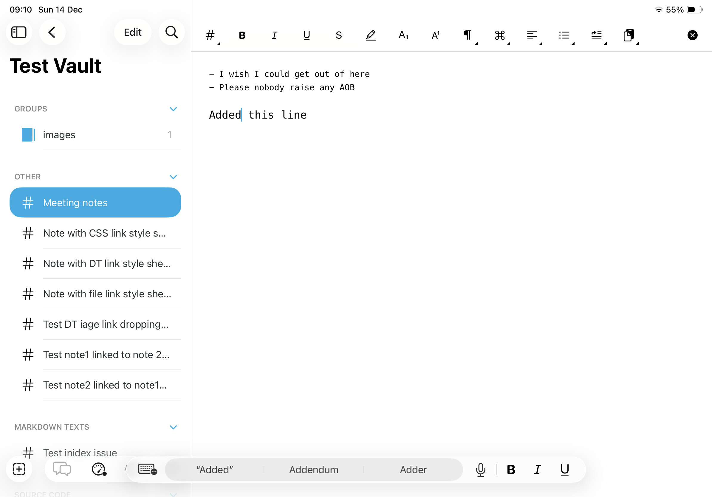

  3. Edit the note in DTTG4

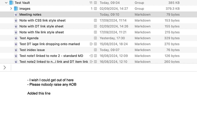

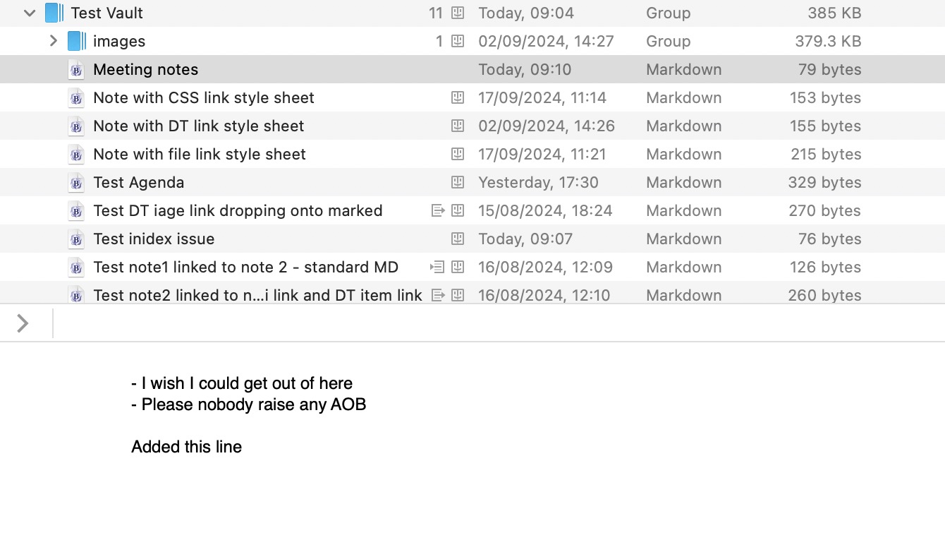

  4. Note now appears as imported in DT.

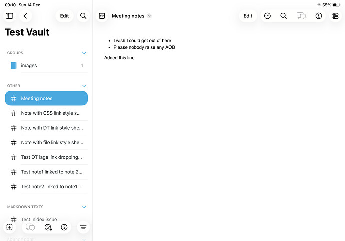

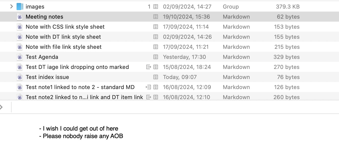

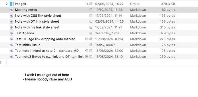

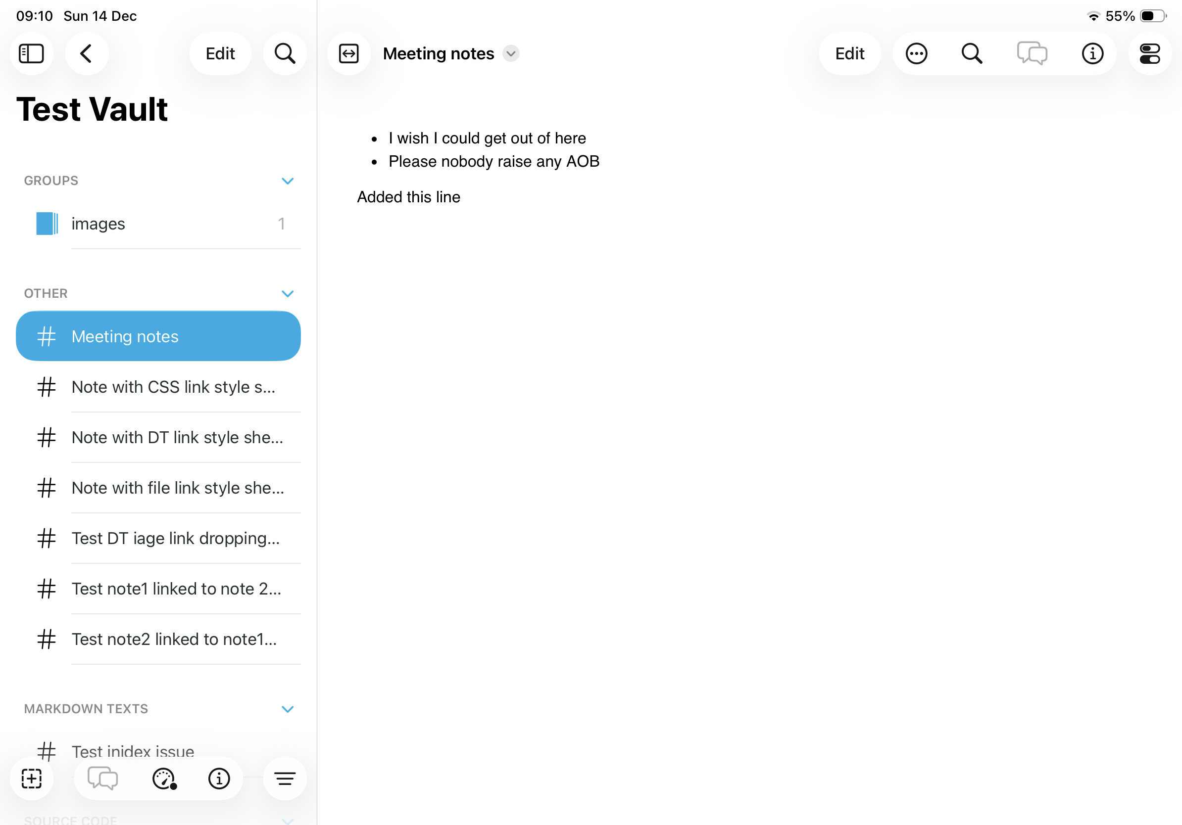

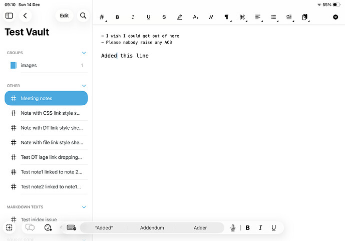

I have narrowed it down. It seems to happen to notes I created before I upgraded to DT4 and DTTG4. Also, I noticed DTTG is not recognising them as markdown.
Here is before and after edit screen shots (to show I am not going mad).
DT4 start:
Edit in DTTG:
After edit:
Now not indexed in DT4:
