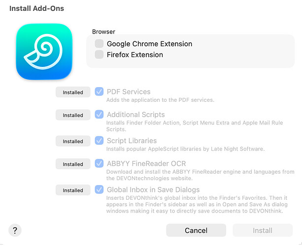

Are all of DEVONthink’s Automation requests allowed in System Settings > Privacy & Security ?
Yes, all DEVONthink Automation requests are allowed. DEVONthink also has Full Disc Access.

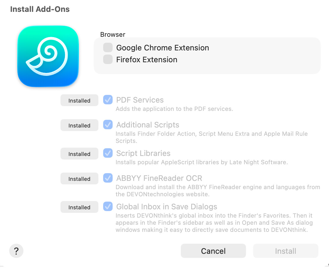

I’m thinking the AppleScript itself may be corrupt as other installed Applescripts function as they should. When I checked DEVONthink→Install Add-Ons… I found options grayed out…see below.

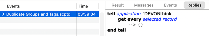

Open the script in Script Editor.app. Show the log and select the “Replies” tab. Now run the script. What do you see in the log?

It would be extraordinarily unusual for the script to be “corrupt”. In fact, if it was, I would be more concerned about the health of your hard drive.
There’s nothing unusual in the Install Add-Ons panel. Everything is already installed so logically the Install button is disabled.
Thank you for that info…
After running the script nothing appears in the “Replies“ tab.

You have to run the script in Script Editor. You do that by pressing the play icon in the toolbar or from the menu via Script > Run.

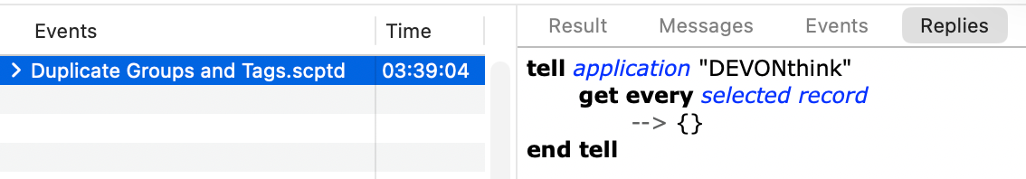

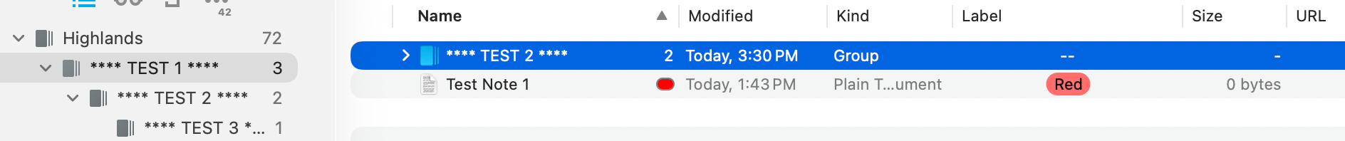

I think some screenshots would help. Can you show us a selection that works and a selection that you would expect to work, but doesn’t?
Senario 1 - No label attribute / This does not work
Log history

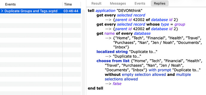

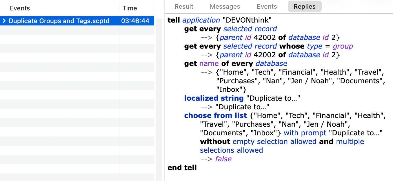

Senario 2 - Record with label attribute / This works
Log History
This has nothing to do with your labeling. You select groups in the item list, not the Navigate sidebar.
