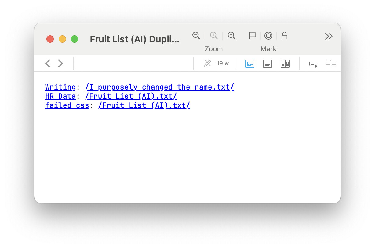

This version generates a Markdown document in the same group as the selected document.
Both the database and the duplicated document are active hyperlinks.

@Charles56: Better? And yes, it’s not pretty but it’s functional :wink:
That’s very slick, Jim. I like it that the results pop up in a Markdown document and that each duplicate document appears as a clickable link. This is what I was looking for. Collect $200 as you pass Go.
PS:
Note the first line. It is a match because this is specifically getting the content hash though the name is different. I don’t know how often people would duplicate a document to another database and rename it, but it’s something to be aware of. However, the content hash is a very specific value. One tiny change changes the hash. So if someone renamed the file and added a return to its content, it would no longer match.
