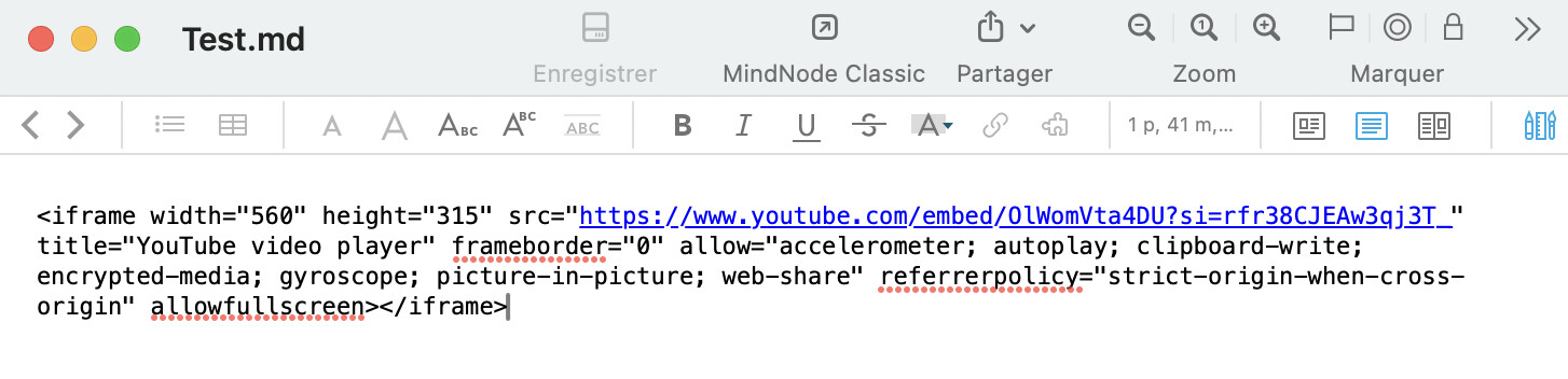

It doesn’t seem possible to embed videos through an iframe link, like in Obsidian.
Do you confirm there is no way, and there will never be ?

Since you mention Obsidian, I’ll assume this is about markdown. I generally have no problem embedding iframes in markdown documents.
It’s much easier if you include a concrete example.

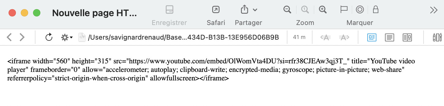

Edit: I’m sure standard YouTube iframes used to work, but they don’t work now. I don’t know why.

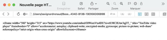

Sharing a Youtube page in a new DT html document works well.

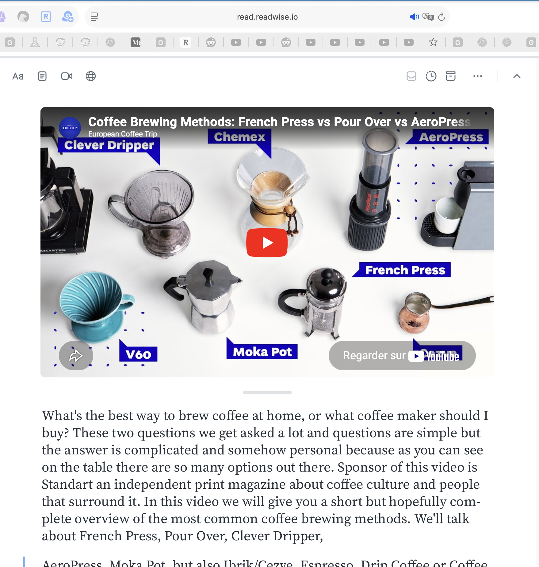

  2. Share a Readwise Reader document to a new DT document

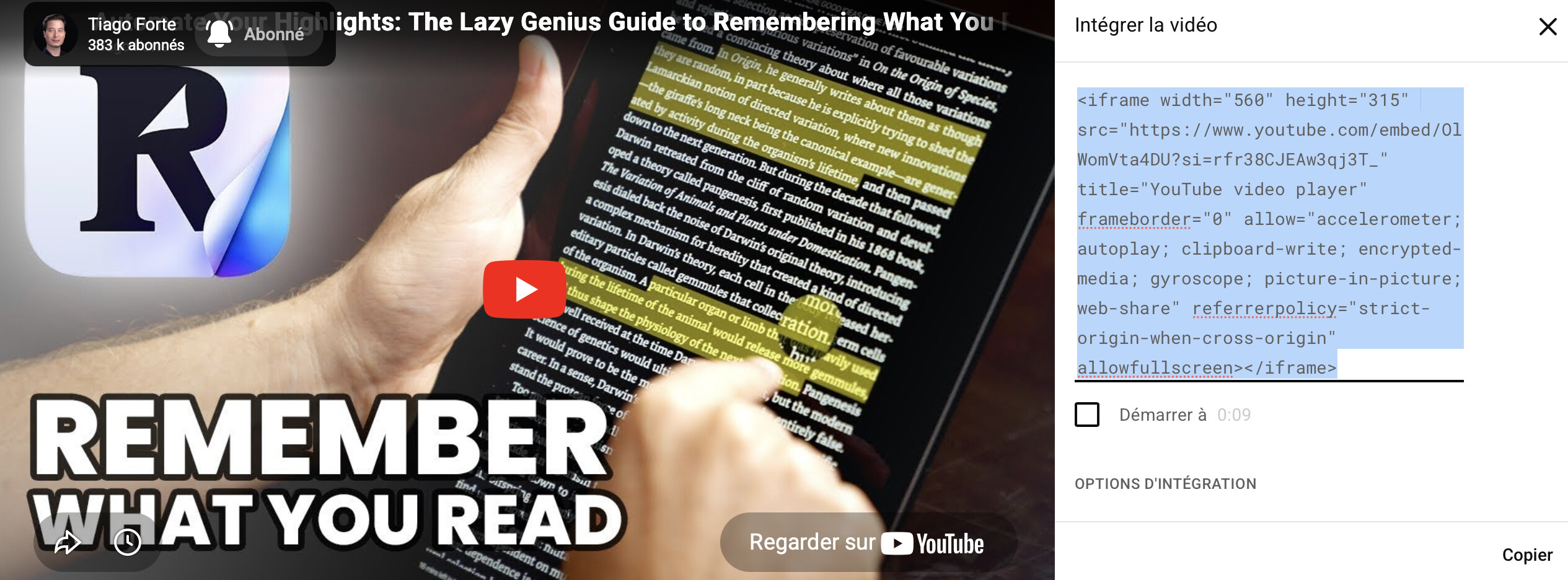

  3. I use a lot iframe links in Obsidian notes, by just copying-pasting the link Youtube provides by the sharing menu. Unfortunately, I I didn’t find how to make it work in DT (see screen copies). The iFrame URL seems inactive.

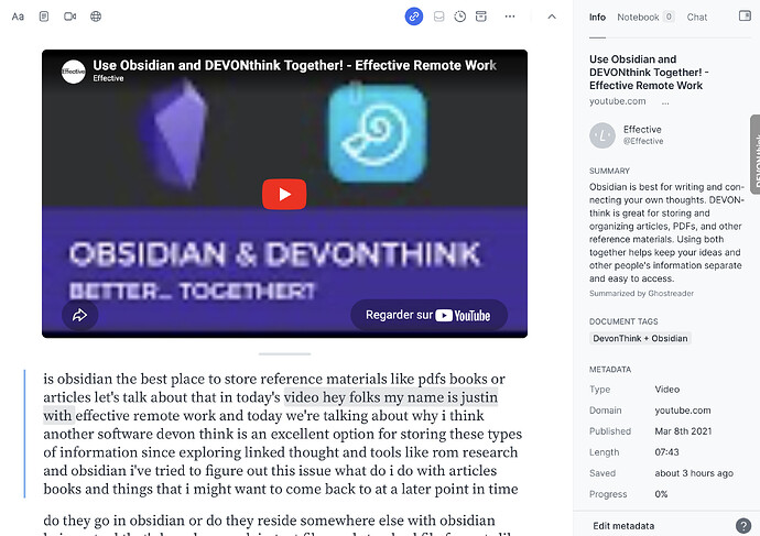

  4. I’m looking for a way to use my Readwise Reader clips into DT, allowing me to also import the video transcription made by Reader. I do this in Obsidian, and get a note with both the video and the transcription.

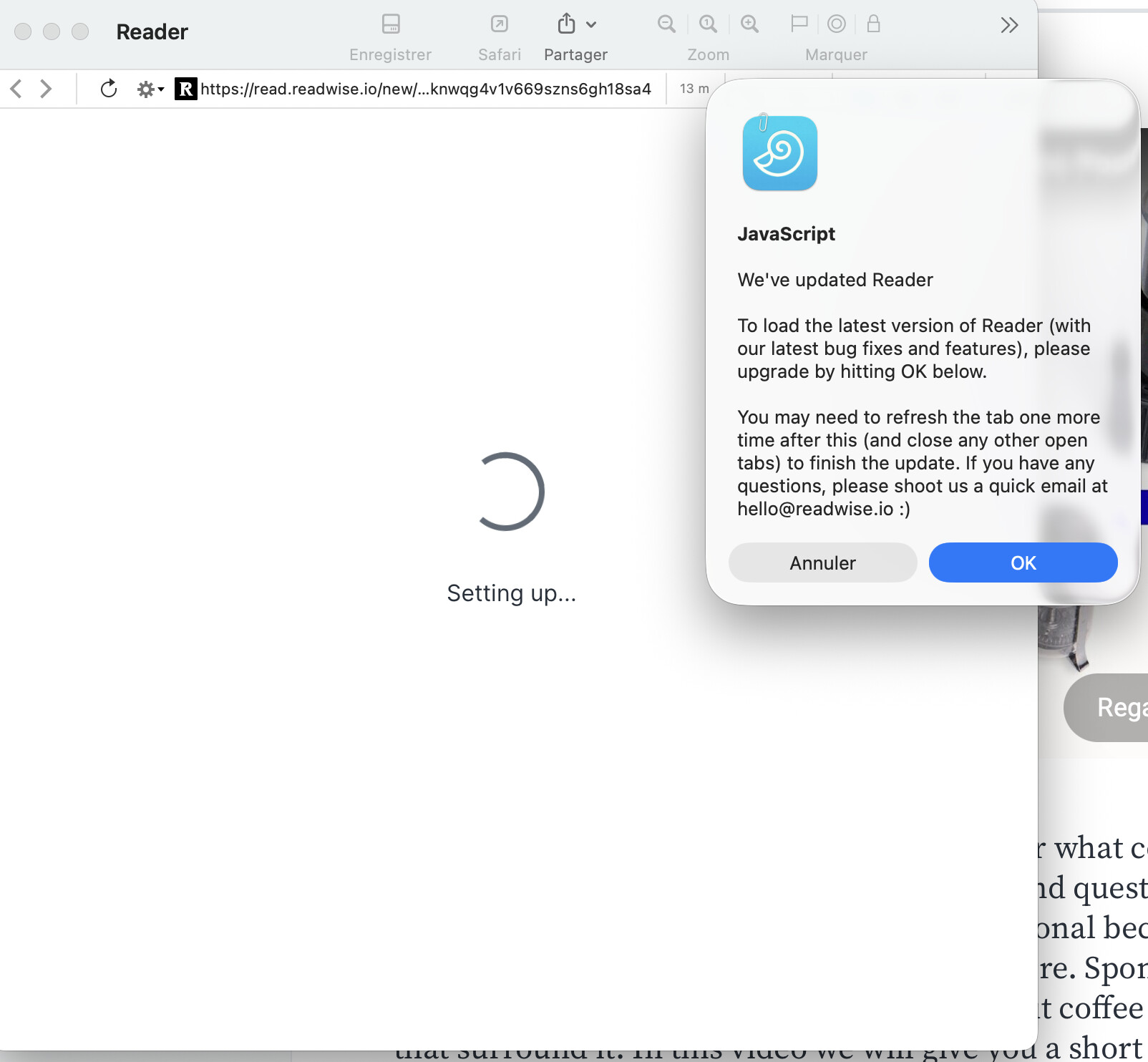

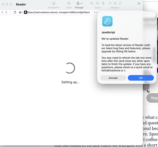

    If I open a Reader document URL in a new Safari tab, and clip it through the DT clipper (my intention being to create a note with the same content than in Reader, in other words import a Readwise Reader note/page into DT), I get an error message (see screen copy). I click on OK, verify Reader is updated, same message.
    Same error message if I copy directly the URL -or the public link- from the RR document/page to a new DT document.
    In other terms, I don’t find a way to get a RR clip into DT, and I don’t get why.

The error message you keep getting is coming from Readwise rather than DT, so it might be worth asking them.

I’ll contact Readwise.

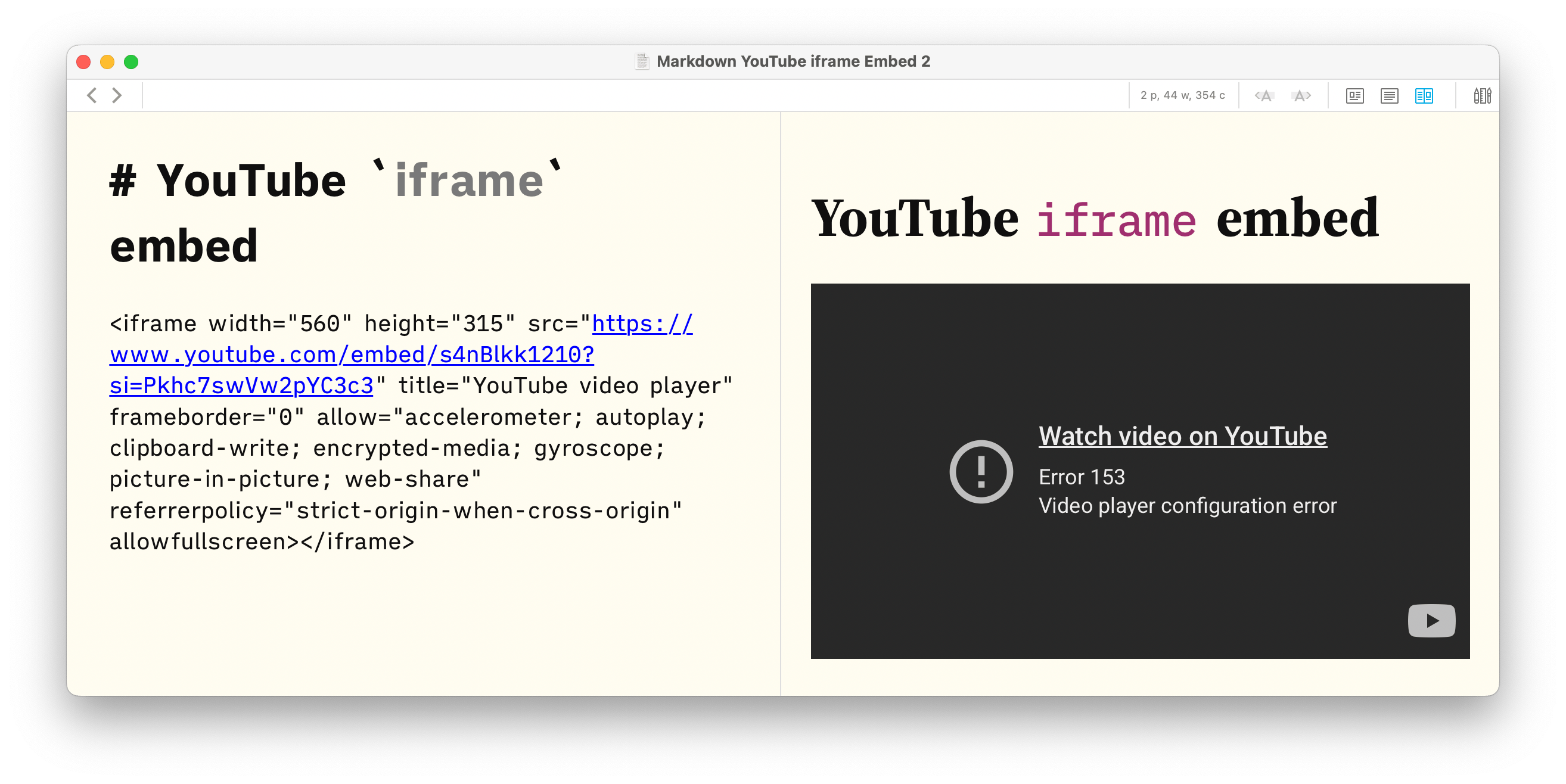

YouTube can restrict playing embedded videos.
Remember: this is DEVONthink, not Obsidian. Just because something works in one application, it doesn’t logically follow it will work in others. And Obsidian is known for doing its own proprietary things.
I guess many websites nowadays would prevent inclusion of their pages or content via iframe elements. There’s copyright, and links aka a elements exist just for this purpose: referring (!) to current in other sites.
I can understand that, though these YT links (either iFrame, or dragging and dropping the URL from the browser) work in other apps (Obsidian / iframe, Apple Notes drag and drop…) so the issue is rather the way the destination app process these url/links ?
I get it, which also means that the issue is on the app side, and that DT could handle these links properly as other apps (Obsidian, Apple Notes..) can ? Could we see this happen in the future ? #FeatureRequest

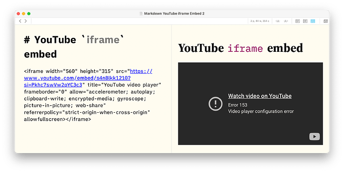

From your screenshots, I can’t see what you do in DT and what you get when the MD file is rendered.
I suggest that you convert three MD to HTML in DT and openness that HTML in Safari. What does its developer console tell you then?
Background: DT does not really do anything with your iframe element – it relies on Apple’s Web framework to render the HTML.

I’m trying 2 things :
  • A. Integrate in DT notes a video link (Youtube video, generally) with its preview. Which I’m used to do in Apple Notes (drag and drop of the URL) or Obsidian (copy of the iFrame link), being able to play the video without leaving the note.
To pretend I understand these HTML things (which Is obviously not the case) : <iframe> : l'élément de cadre intégré - HTML | MDN

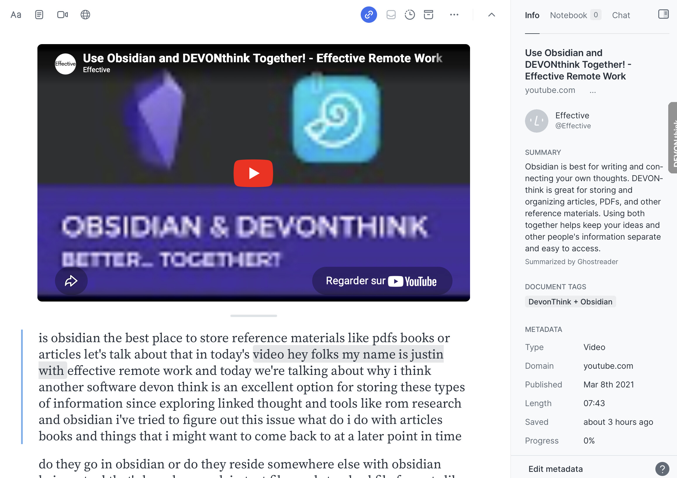

  • B. Import in DT Readwise Reader éléments/pages/notes, like :
  1. Direct link (browser URL) : Reader
  2. Public link : Use Obsidian and DEVONthink Together! - Effective Remote Work | annotated by renaudsavignard
Why ? because these Readwise Reader documents are
  • already tagged,
  • include the transcript under the video (see screen capture),
  • and annotations already made..
Very convenient. That’s why I would be happy to use them, or some of them in DT. I have thousands of these valuable pieces of information.

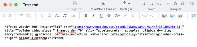

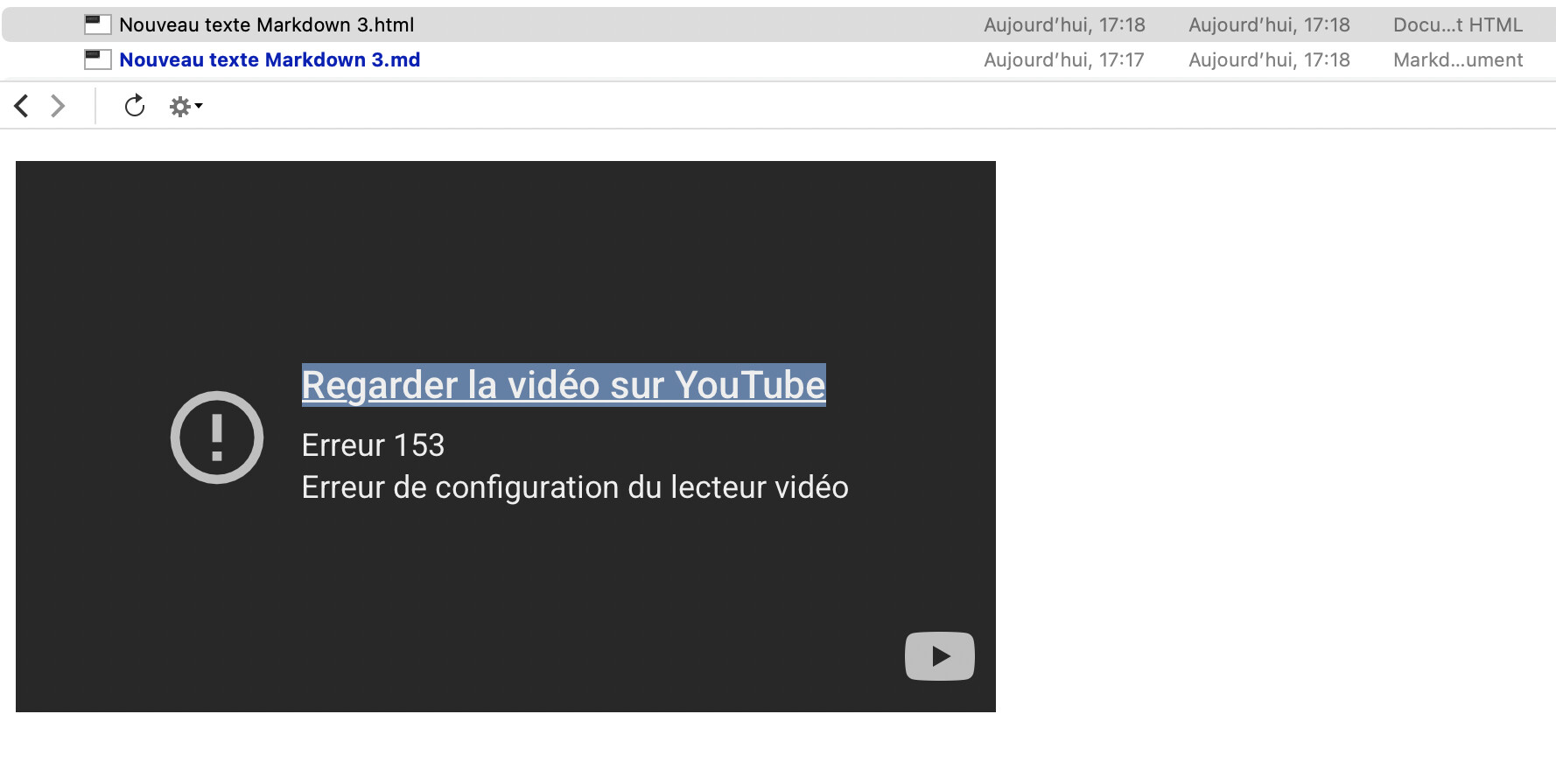

Ok here is what I get :
  • 3 md files with 3 different iframes pasted, then converted in HTML
  • 3 HTML links extracted from these converted files :
Regarder la vidéo sur YouTube
Screen copy of one of these html files attached
  • Safari console log copy :
[Error] XMLHttpRequest cannot load https://www.youtube.com/youtubei/v1/log_event?alt=json due to access control checks.

But as you can see, the server responds with an HTML error. And some kevlar_base_module is involved. Perhaps an extension you’ve installed in Safari? Systemwide?
You could try to open the HTML with another browser like Chrome or Firefox and see if the same problem occurs. In any case, I doubt that DT is the culprit here.
Tried in Chrome, and looked in the console and asked for an interpretation : Failed to load resource: net::ERR_NAME_NOT_RESOLVED – Qwant Search
