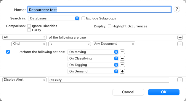

I’ve got a group “00 processed” where all my processed imports end up before classification. I don’t want that group itself to show up in Classification suggestions so I’ve selected “Exclude from classification” for the group.
I was surprised to find out that I can now also not use that group anymore if I use it as the “Search in” group for a smart rule that triggers “On Classifying”. If I select a higher-hierarchy group (e.g. Databases) the trigger does run which seems inconsistent. I would expect the behavior to be that “Exclude from classification” would only exclude the group from showing up in Classification suggestions, not prevent running smart rules with “On Classifying” triggers.
Selecting “00 processed” for Search In does NOT trigger the alert when classifying a document in the group “00 processed”
Selecting “Databases” for Search In does trigger the alert when classifying a document in the group “00 processed”

How exactly did you move the item? So far I couldn’t reproduce the issue, a new group and new smart rule searching only in this group work as expected.

And the destination group is a subgroup of 00 Processed? Otherwise the smart rule should indeed not be triggered if it’s only searching in 00 Processed.
No - the destination group is not a subgroup of 00 Procesed - it’s actually a sibling (see the group hierarchy in the screenshot earlier). The sibling (e.g. the group ‘fiddle’ is NOT excluded from classification).
But here’s what I’m understanding: the “search in” should specify the target for the On Classify item. It is not where the item is that triggers the On Classify trigger. That wasn’t clear to me before - I thought “Search in” was meant where the item the action was triggered from should be - not where it would trigger to.
That’s right, all triggers which do not offer before/after variants are triggered afterwards.
That is correct.
The Search in dropdown specifies the location to watch for activity, in this case the group receiving the classified file. The smart rule is unaware of the activity of other locations.
