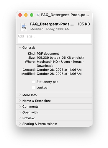

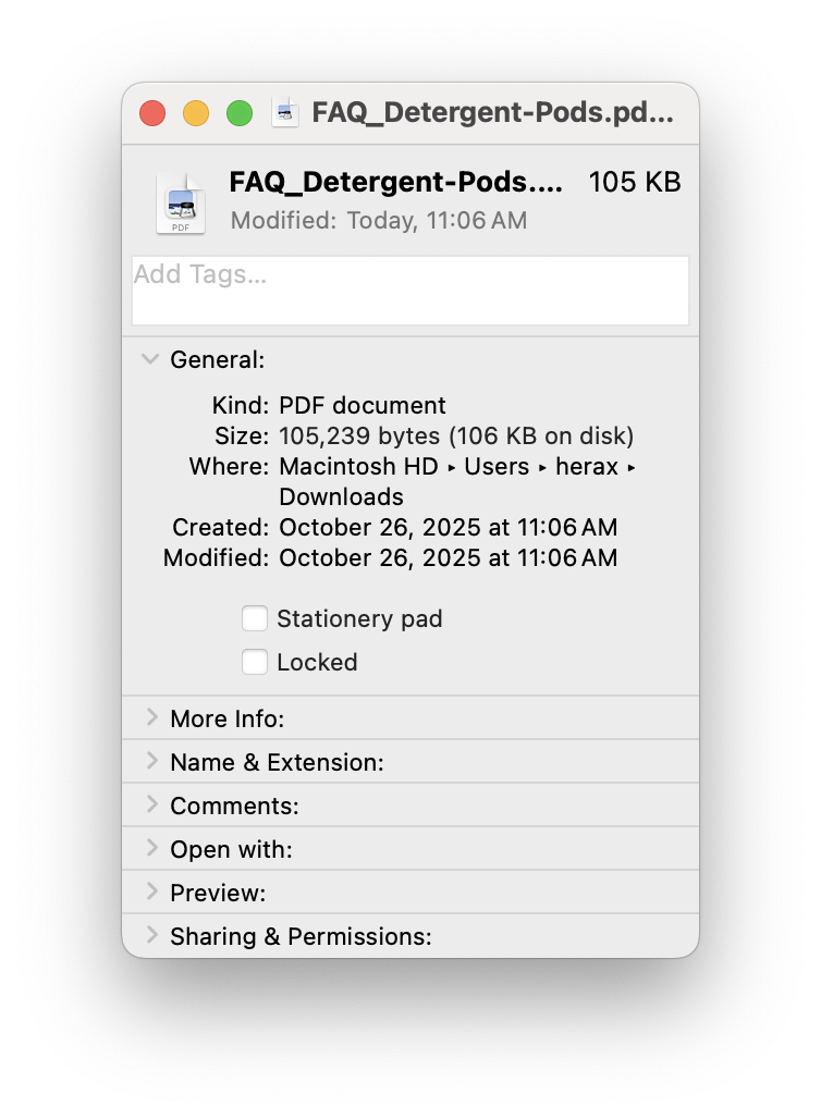

Here is a PDF on the dangers of eating laundry detergent pods.
I just downloaded it so the file has a creation and modification date of 10.25.2025. That is accurate as far as the file on my Mac goes.

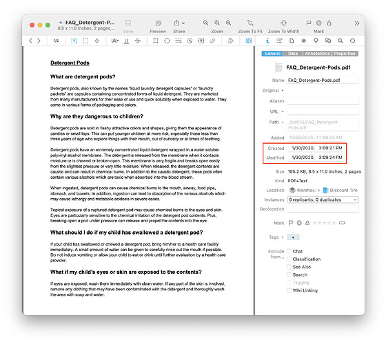

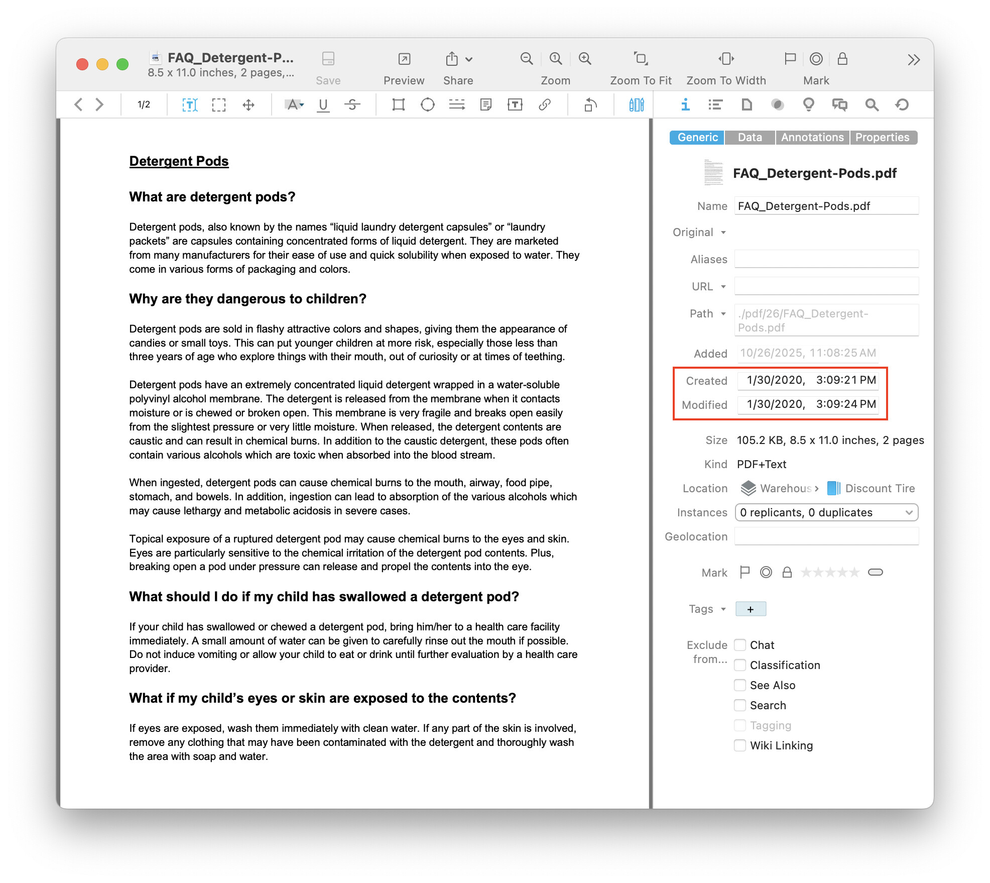

However, the actual date of creation and modification is years ago. With Files > Import > Use content creation and modification dates enabled, the PDF document properly shows 1.30.2020 for those dates.

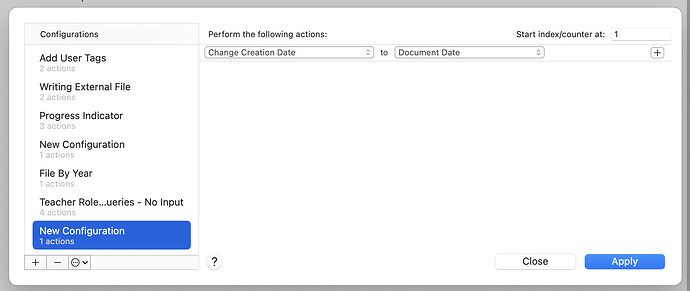

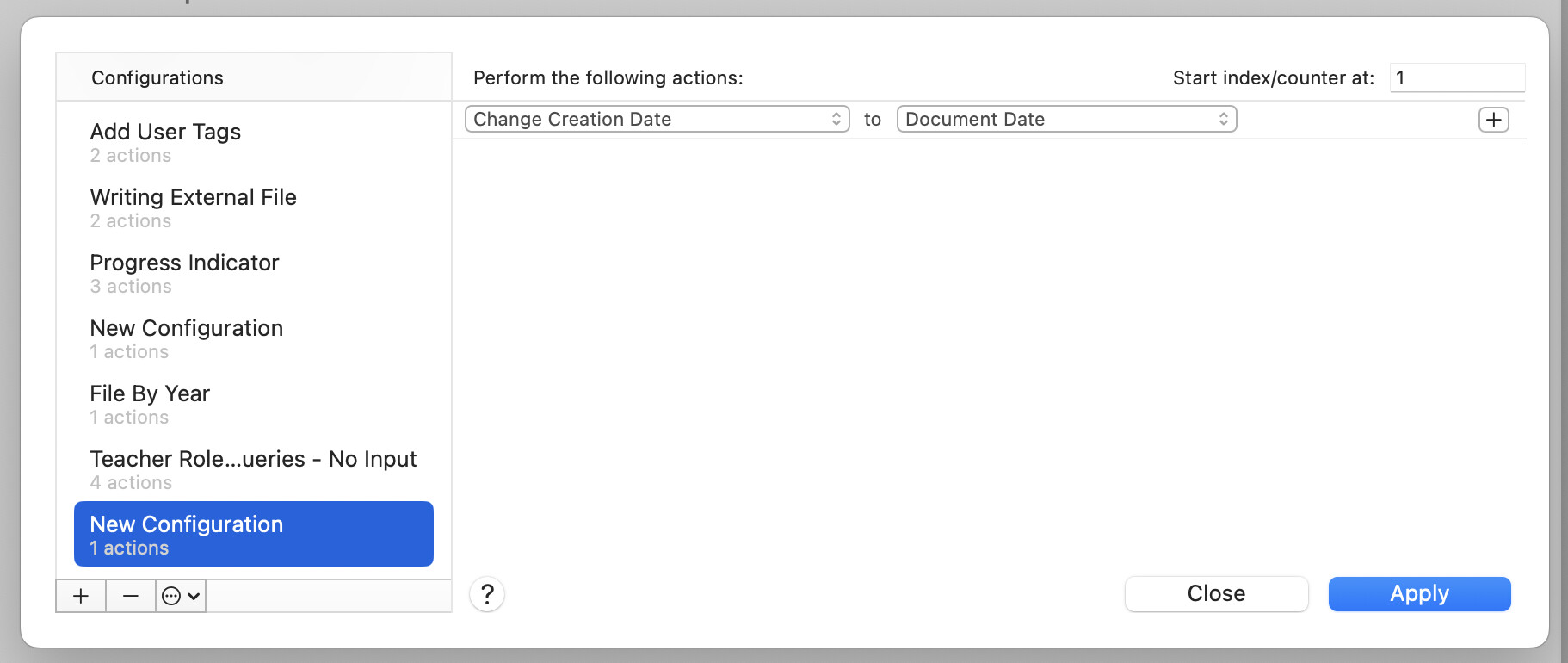

Here is a simple batch process example in DEVONthink 4…

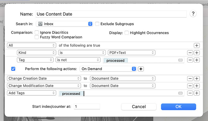

You’re welcome. That’s easily done as a smart rule as well…
I have that already created in a smart rule but I thought with the option I could remove that smart rule. But now I also created a batch process. never used them before
