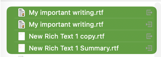

If you select multiple files in the item list, it filters out anything but RTF(D) files and acts on those it finds, e.g.,…
I guess you tried selecting files with an annotation? As it is, the script doesn’t work on such a selection. You need to select the actual annotation files themselves.
Both @BLUEFROG’s and @chrillek’s script process multiple files in one go. They are written to execute a set of commands on all “selected records”.
All items in a database are referred to as “records”. Groups, smart groups, tags, documents, annotations—they are all “records”. You’ll see this term in almost every DEVONthink script.
selected records (AppleScript) or selectedRecords (JavaScript) refers to your selection in the item list. If the front window is a document window, which has no item list, selected records instead refers to the record displayed in the window. (In a sense you selected it by opening a separate window for it.) That explains why the script does work when you open the annotation in its own window.

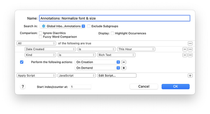

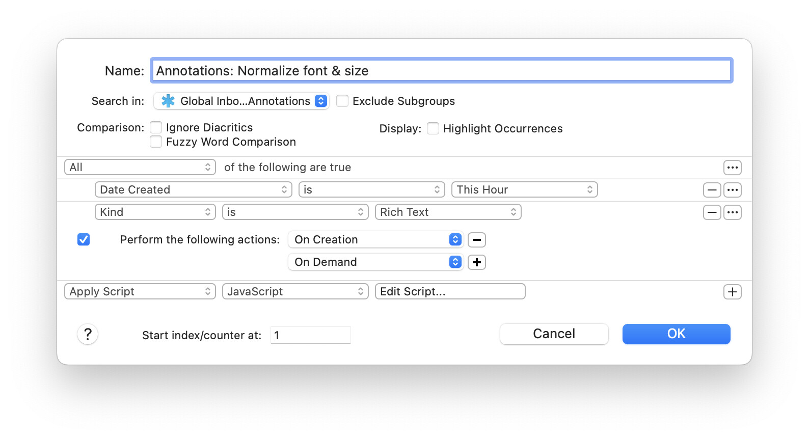

Going forward, you could even apply such a script to any new annotation files automatically on creation with a smart rule.
You need a scope targeting just your annotations, so this assumes that you use the default annotations group. Here I selected Global Inbox > Annotations
The magic happens in the “Apply Script” action. Set it to either “AppleScript” or “JavaScript” and click the “Edit Script…” button. This gives you a popup where you can enter your code.
A script for a smart rule is slightly different as you need to wrap your code in a performsmartrule function (JavaScript) or on performSmartRule handler (AppleScript).
Like chrillek I prefer JavaScript:
	records.forEach (r => {
		const txt = r.richText;
		txt.font = "Georgia";
		txt.size = 18;

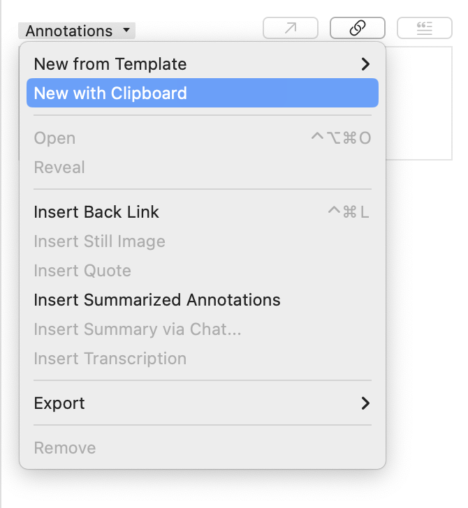

I’m not sure what trigger would best fit your workflow. “On Creation” works when I paste into the empty annotation field in the inspector, though with a little caveat. The annotation file is only “created”, thus triggering the rule, when I move focus away from the field.
If I instead use the dropdown menu and select “New With Clipboard”, the rule triggers immediately.
