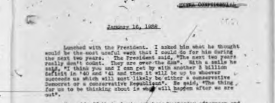

I have long used the built in OCR and never noticed image degradation as bad as it is at the moment. See the example below which takes it from readable to almost not readable. Is there a recommended solution within Devonthink?
What settings are you using for the OCR? Turning off the auto correction of deskew improves the output, see image below.
ABBYY would generate the output image after its preprocessing so the blurring could be caused by a very small deskew correction.
Thank you for this suggestion – I wasn’t aware of that setting. So I did go in and turn off deskewing and re OCR’d the document, but again unfortunately the result is not good.
Maybe there’s something else I’m doing wrong – as I say I’ve used the built-in OCR for years without problems. I’m aware the quality of what I’m trying to OCR is not great (I think it’s a scan of a microfilm) so I certainly don’t expect the OCR to be perfect – I’m just unhappy that the OCR now blurs the document making it difficult or at least tiring to read.
Can you take a screen shot of your OCR preferences and I will see what is different from the settings I am using.
Here they are – I also tried turning off ‘page orientation’ but results were about the same.

Thank you! OK I loaded in the new version of OCR and tried the same document again. Here are the results.
This is document before OCR:
This is the document OCR’d set to 200 dpi: In this case none of the text was selectable.
This is the document OCR’d at 300 dpi. In this case the text is selectable only as shown:
Again I understand I am starting with a not-great quality document. I do feel the OCR results used to be better than this but can’t demonstrate that.
I haven’t been able to reproduce the same results, is it possible to send a copy of the original document. I have send you a message with the email address to send it too.
