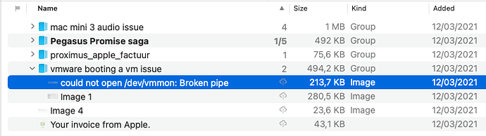

It appears my databases are strayed with items that show up as “File not yet available”
My syncstore resides on a in house mac mini that provides a webdav syncstore.
My idea is now to try to create a rule that will move all these items shown as “File not yet available” into a separate group / even into a separate DB, thus cleansing my existing DB.
Can anybody help me out with “how” to filter out these “File not yet available” items? I can not use file size as they do indicate a certain file size.
One way DTPO identifies these files is by showing a “cloud” icon at the far righthand side of the “Name” column.
