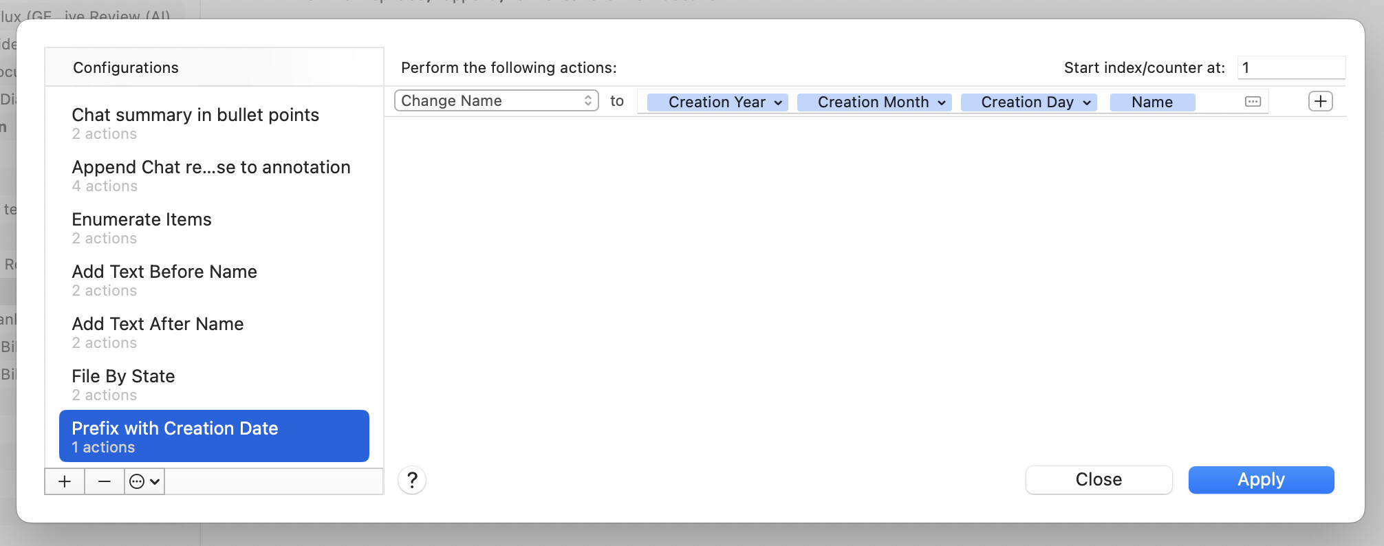

Thank you BlueFrog. That batch processing configuration file worked. Control-Command-B does show 4 x entries ‘Prefix with Creation Date - I action’. Is this normal?

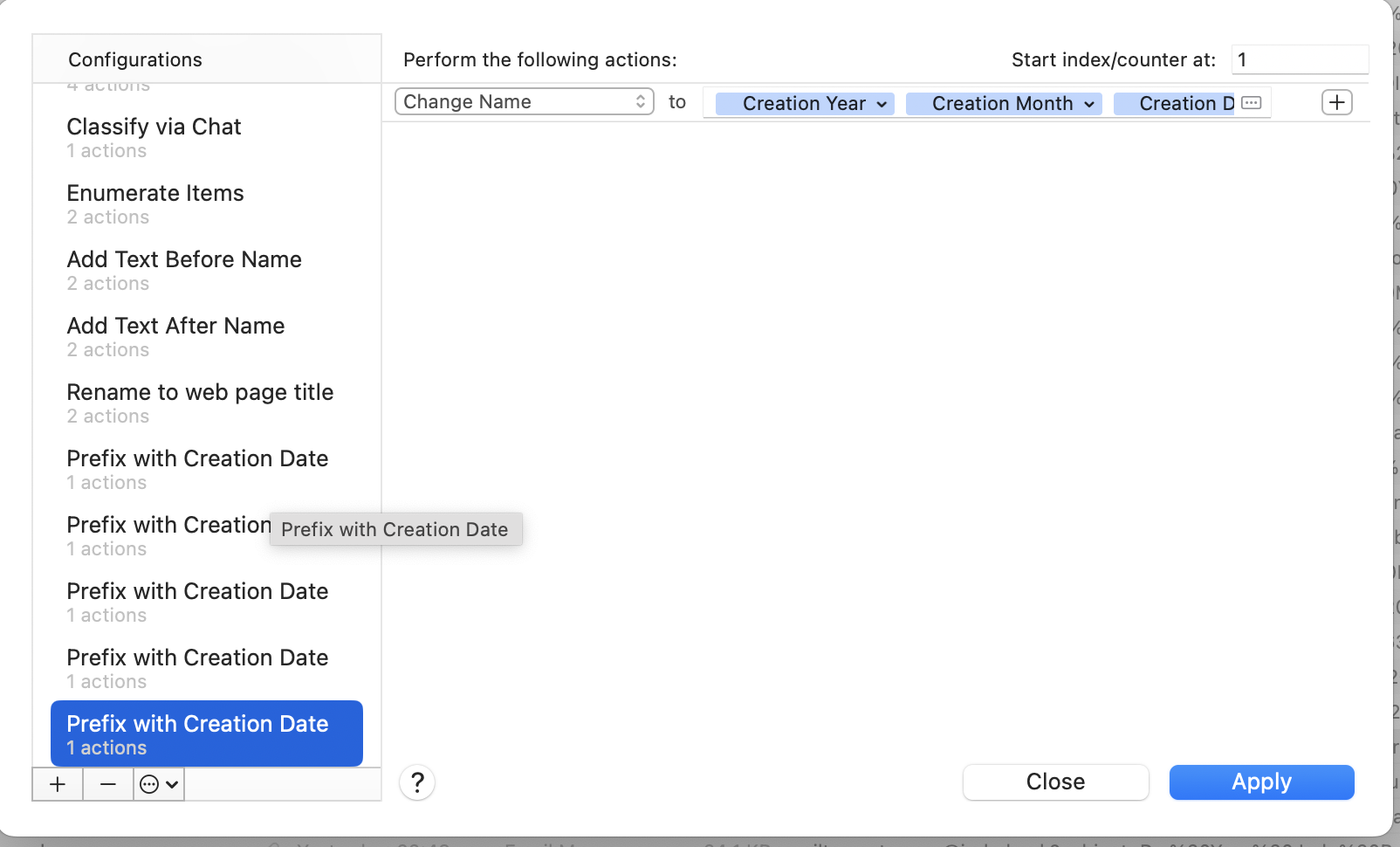

Could you post a screen capture of this?
Seems that Jim’s configuration was added multiple times. One is of course sufficient.
