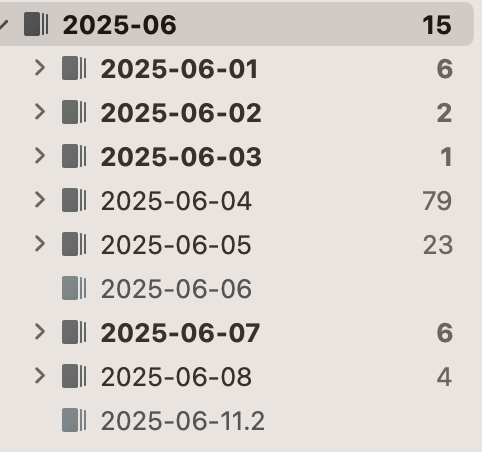

Attached is a screenshot to give you an idea of my year/month/daily folder structure.

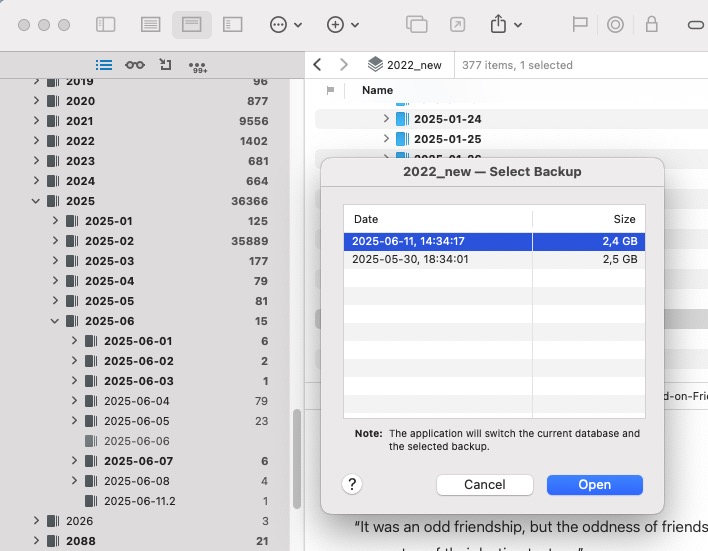

No, you can’t compare the internal backups between machines. You can hold the Option key and choose File > Restore Backup to rollback the metadata on a database. I would do this on the faulty Mini first to see if it’s just a metadata issue.

Yes, I would disable sync first so you can see what the result is. In fact, I would try to isolate one Mac and get the database into a master state, including passing a Verify & Repair. Then I would do a manual backup taking note of the date of the backup. I would then remove the compromised database from another Mac and import the newly curated one and verify it. I would then follow that procedure on other Macs, including doing a manual backup of each as well.
