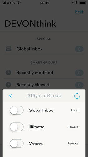

Now I’m here:
I wish to sync just the “Memex” database, if I switch the option that now is on “Remote” it starts to download the database; I think the whole dabatase because of the size, and if fill up my iPhone…

I checked and is already set on “On Demand”. When I turn the switch from “Remote” the database start downloading, but fill up space on the phone. What seems strange to me is that there is the need to download the entire database (as if you do not want “On-demand”), and the space occupied on the phone is greater than that of the database on the Mac (2,78 GB on the Mac versus >4,48 GB on the iPhone). I thought that by setting “On-Demand” an index was only downloaded, with groups and titles of the notes.
I tried to free some space on the iPhone but without luck, trying to re-synchronize this time on the phone were uploaded 5.18 GB, then it was filled. I still do not understand why an archive of 2.78 GB on the mac increases so considerably on the iPhone. Has anyone had similar experiences?
